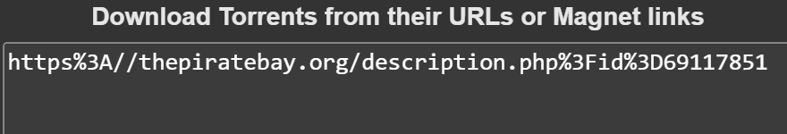

I'm running the webUI only for 5.0.3 on an Asustor AS5402T using docker/portainer. I can search for torrents but when I want to download them, the URL shows up encoded like below. If I don't correct the URL, it fails with a "No such file or directory [generic:2]" error.
URL encoded.png (18.71 KiB) Viewed 19488 times

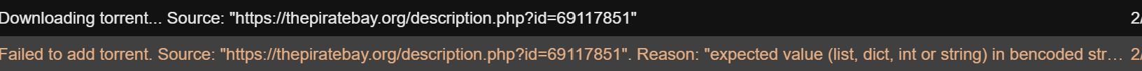

However, when I correct the coding, I get a python error about missing data in the torrent file.
python error.png (28.17 KiB) Viewed 19488 times

Re: Unable to add new Torrents - qBittorrent 5.0.3
How do you download them though? The link you got there is the description link and NOT the actual link.
If you double-click or right-click -> Download, you get the pop-up with all the details and you can start the download. As you can see, the link is a magnet link there - TPB does not publish torrents, they haven't done so for years now.
