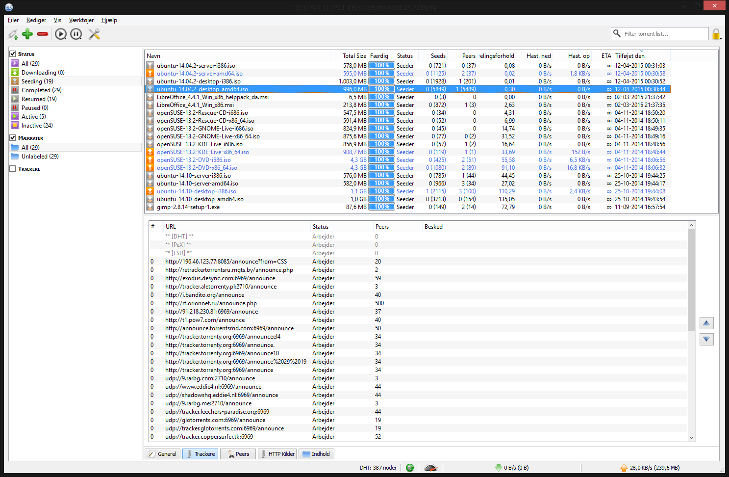

Hi
I am running the latest beta.
I am wondering if the behavior of the tracker tab is as designed.
When I start the trackers is as they always has been. But after a few minutes there is a lot of trackers.
I don't know if it is good or bad. Good if it helps finding seeders/peers, bad if it a way to track my doing.
As example i have this ubuntu seed.
Normally there are only 2 trackers torrent.ubuntu.com and ipv6.torrent.ubuntu.com.
They are also present in the list.
One funny thing is, that also trackers, which do not work, is on the list.
Another thing is, that the trackerts is not in the tracker list to the left ??.
Regards
/Jensen
sledgehammer_999
Posts: 2443
Re: [unofficial]qBittorrent git master builds: 3.2.0beta_20150329_c6bfcd0
Post by sledgehammer_999 »
I think the extra trackers come from "exchange trackers with other peers". Try disabling it from the advanced settings.
