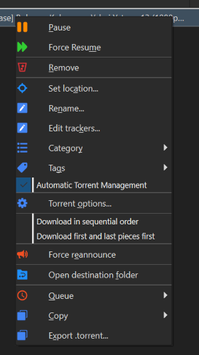

Then I remembered that a tracker I'm a member of had a specific version of qB they recommended (4.3.9). I tried using that and now I could seed and DL. But 4.3.9 doesn't have some of the better workflow that later versions do like being able to set the torrent Category immediately and starting the torrent with a couple of additional keystrokes. Or when you right-click to the menu there are no underlined letters for faster access which I think began with 4.5.x.
qBit Screenshot 2024-01-12 151110-2.png (35.48 KiB) Viewed 2797 times
I tried using various versions of 4.4.x, 4.5.x and 4.6.x without success. Each time I let the installer use the exact same settings I previously had but qB only works with 4.3.9 on my machine now.
I've used AutoHotKey to try and replicate the same ease of use as later versions but it's not quite the same. So I'm wondering if someone can help me figure out how I can use 4.5.x or if it's possible to have the context menu of 4.3.9 have letters be underlined for ease of use.
