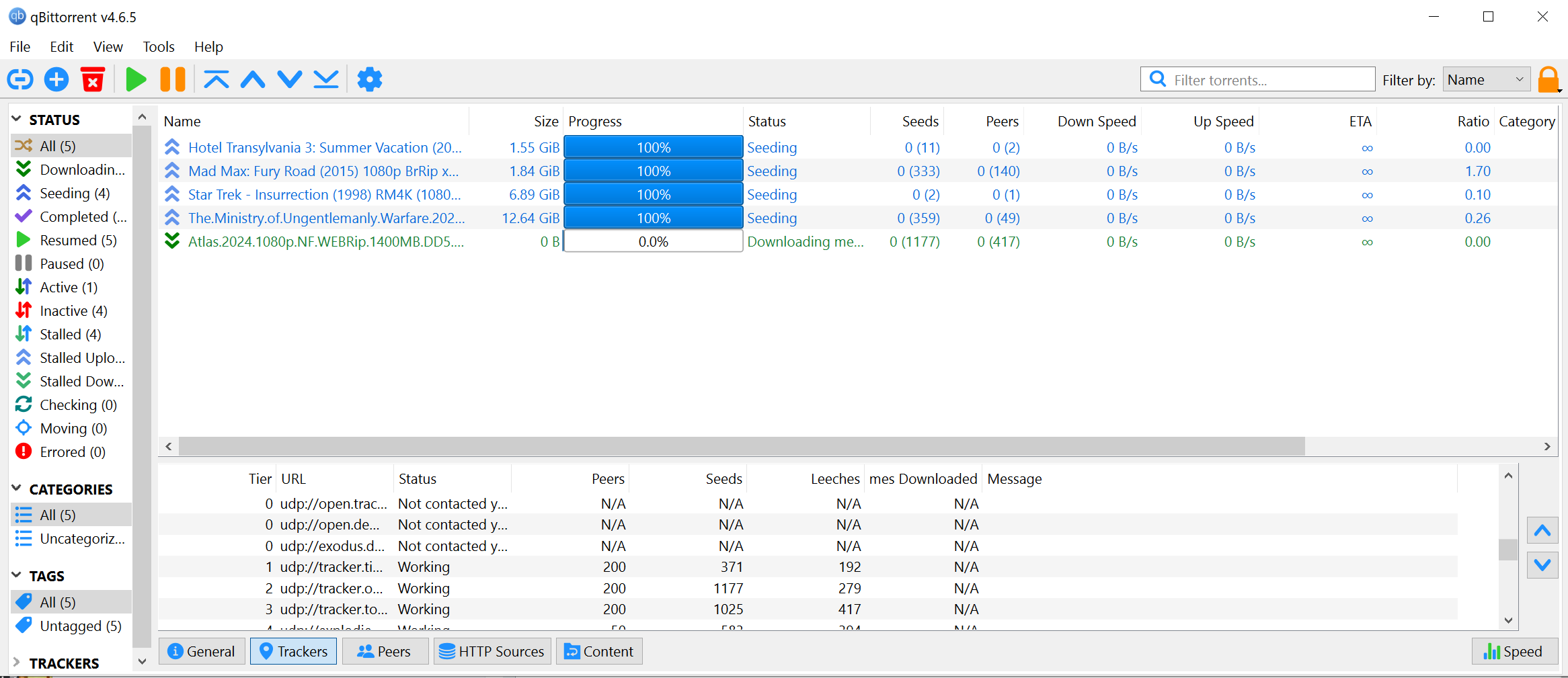

Everything was working alright (besides downloads being incredibly slow through VPN connection) until a few days ago. I haven't changed any settings recently. qBittorrent is connected through my VPN Interface. qBittorrent is still an allowed app through my firewall. I use a lesser known VPN called VeePN which has worked well the last 4 years for me.
All new torrents get stuck on "Downloading metadata". It does appear to load some hosts and peers but doesn't actually start downloading anything. If I switch to "Any Interface" and turn my VPN off, it downloads just fine at fast speed. Turn it back on mid-way through a download: it stops completely even with pausing/resuming the torrent or restarting the app.
I tried uninstalling/reinstalling qBittorrent. I tried downgrading the version also. I tried going into my router settings and setting up the listening port as port forwarding and then enabled the port through my firewall. Nothing helped.
Seems like it's just not connecting to the trackers when I go to the trackers list, labelling them as "Not working" with reasons such as "timed out", "The requested address is not valid in its context", "skipping tracker announce (unreachable)" etc. When I turn VPN off: All trackers are found as "Working" and downloads resume as normal.
Any suggestions? My VPN app is up to date with very few settings even available to tweak and again, I haven't changed any settings.

I'm a Linux guy but Windows may have something similar. Under Preferences and then Advanced, there is a option for Network Interface pretty close to the top. Could it be that it is set to only use the connection when not connected to the VPN? If you select the interface itself and then tell another piece of software to only allow it to use the VPN, it kind of hits a dead end road.
I have mine set to only use the VPN interface. When the VPN loses its connection for some reason, QB stops and acts a bit strange. I restart the VPN or fix whatever caused the VPN to stop working and QB goes back to normal. It kinda acts like what you describe.
Also, check the Execution Log. It logs when it sees a new interface, loses connection and other things. It may have a clue if the above doesn't help.

You do have working trackers in the image. It's not unusual to have some of the trackers not working.
