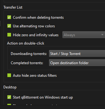

I returned the light scheme (dark was not usable, disaster). But it would be great back light scheme in web UI. It's possible?
Screenshot dark theme - do you see the check box?

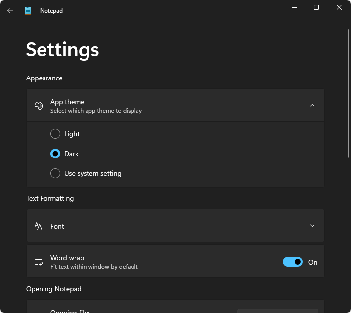

Just because I like dark mode for the majority of things (which is why I have set Windows to dark mode in the first place), there are some apps I prefer in light mode.
I have yet to come across an app that forces you to the Windows setting.

I agree that it should be a choice, like it is in every program I have encountered so far, including the Windows built-in apps.Mongokino wrote: Fri Oct 04, 2024 5:04 am Registered here only to say that devs MUST fix this ASAP or I will look for another client. Thank you!

My point was, they give the option of what mode you want to display the program in.Peter wrote: Fri Oct 04, 2024 10:01 amThat's for Modern/WPF/whatever abomination Microsoft is calling them lately apps I believe. Ie.: Not normal applications/programs.kingmustard wrote: Fri Oct 04, 2024 9:58 amI agree. It should be a choice, like it is in every program I have encountered so far, including the Windows built-in apps.Mongokino wrote: Fri Oct 04, 2024 5:04 am Registered here only to say that devs MUST fix this ASAP or I will look for another client. Thank you!
All other programs I have encountered so far do, too.
It is nice to be given the choice outside of your Windows settings.
