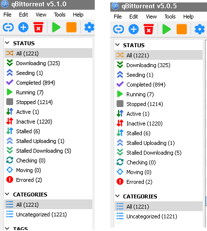

Something changed.

utoniun wrote: Mon Apr 28, 2025 3:27 pm Something changed.
this is it, thanks for the awesome montage! perfect! also, good to know that others have the same problem

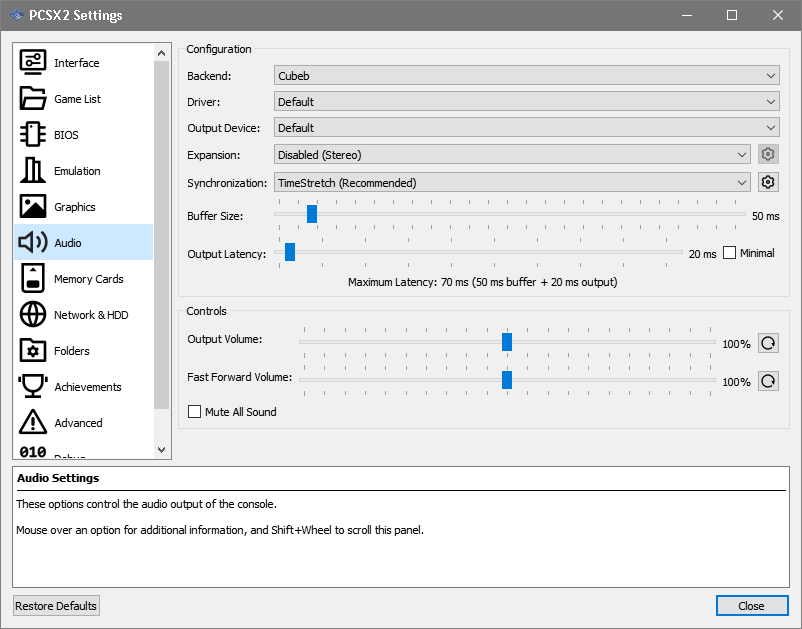

It's a ClearType thing. I think 5.1.0 forces cleartype on, and users that were already with it on don't notice the change. I can't stand cleartype and have it off.
The same issue with other applications that use QT, like PCSX2 or RPCS3, where cleartype seems to be forced and it's unpleasant to the eyes. Don't know what to do about it.

Here is another comparison.
1 - 5.1.0 - ClearType Off in windows - Ignored
2 - 5.0.5 - ClearType On in windows
3 - 5.0.5 - ClearType Off in windows

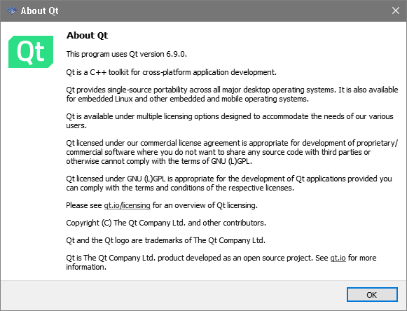

It's the jump from QT 6.7.3 of qbittorrent 5.0.5 to QT 6.9.0 of qbittorrent 5.1.0 that is causing the issue.
5.1.0 vs 5.0.5.png (52.47 KiB) Viewed 14090 times

I don't know if your eyes are super sensitive or mine are shot, but I don't see any difference between your three example screenshots.

See if your browser is at 100% zoom. If not, try that.
Anything but 100% ruins the ClearType Off example.
You could also save as the .png and open it at 100% in your pic viewer.
