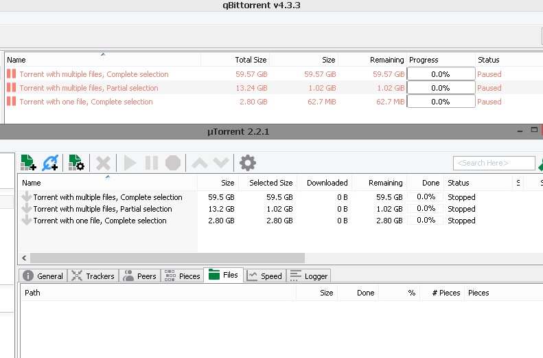

ionGL wrote: Fri Mar 05, 2021 8:04 pm
rumanzo wrote: Fri Mar 05, 2021 7:07 pm Did you mean that problem only with not fully completed torrents?
No. The problem with wrong Size and Remaining values is with torrents that are not even started!
Force recheck on those does absolutely nothing.
I din another test, on a 3rd fresh new computer, with windows8 64. I even tested older versions of qBittorrent, but it made no difference. The findings:
I used bt2qbt_v1.4 and bt2qbt_v1.9 only 1 .torrent to compare the resulting .fastresume.
As i was playing, i only changed a letter after qBt-name45: in the .fastresume generated by 1.9 to see if it updates after i start qBittorrent.
It did update the name and it also now sees the CORECT values for size and remaining.
I generated a new .fastresume with the same .torrent and resume.dat by running bt2qbt_v1.9 and again the values for size and remaining are wrong.
Then if i open the .fastresume and even in an empty space if i hit backspace and then space, just a single change that triggers notepad to want to save the file is enough for qBittorrent to pick up the correct values for everything.
Does this make any sense?

Went at it again an tested all the releases for my "Example: A 1GB .torrent with 10x100MB files." from earlier.
v1.0, v1.1, v1.2, v1.3, all of them get the values right for "Total Size", "Size", "Remaining", file priorities are spot on.
Starting from v1.4, the "Total Size" is correct, but "Size" (the value for the selected files) and "Remaining" are messed up. They are given the same value as "Total Size".
Force recheck does nothing, as this is a torrent that has not been started yet.
I think this could be fixed if v1.3 gets it right.

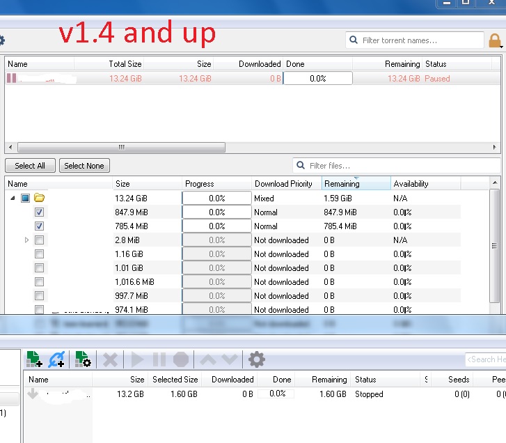

I got yet another new computer to test, windows7 x64 this time.
- Installed fresh utorrent 2.2.1 and fresh qBittorrent 4.3.3 (then many older versions to see if it makes any difference and it doesn't)
- Loaded 1 .torrent with multiple files into utorrent, selected only 2 files, exit.
- Used all bt2qbt releases from v1.0 to v1.10.
- From v1.0 to v1.3, the values for total size, size and remaining are picked up correctly, as seen here: https://i.postimg.cc/GhJkXTHb/v1-3.jpg
- Starting with v1.4, the values for size and remaining are wrong: https://i.postimg.cc/vHMnx8Xk/v1-4-and-up.jpg
I think a v1.3 with "Transfer torrent modified names" would save me.

ionGL
Re: Windows tool for migration from Bittorrent/uTorrent/Deluge to qBittorrent
Post by ionGL »
Thanks for building, rumanzo. I got and tested this latest one. Still something is wrong.
This is how it picks up a torrent with partial selection: https://i.postimg.cc/CKPfXSTt/v1-10-14march2021.jpg
Force recheck does nothing, the values for "Size" (corresponding to "Selected Size" in utorrent) and "Remaining" are not the right ones.
The exact same torrent and selection done with v1.3, everything is picked up just fine, minus the edited torrent name: https://i.postimg.cc/GphyX9NG/v1-3-14march2021.jpg
Since v1.4 something was introduced that messed up the "Size" and "Remaining" for torrents with partial selections.
