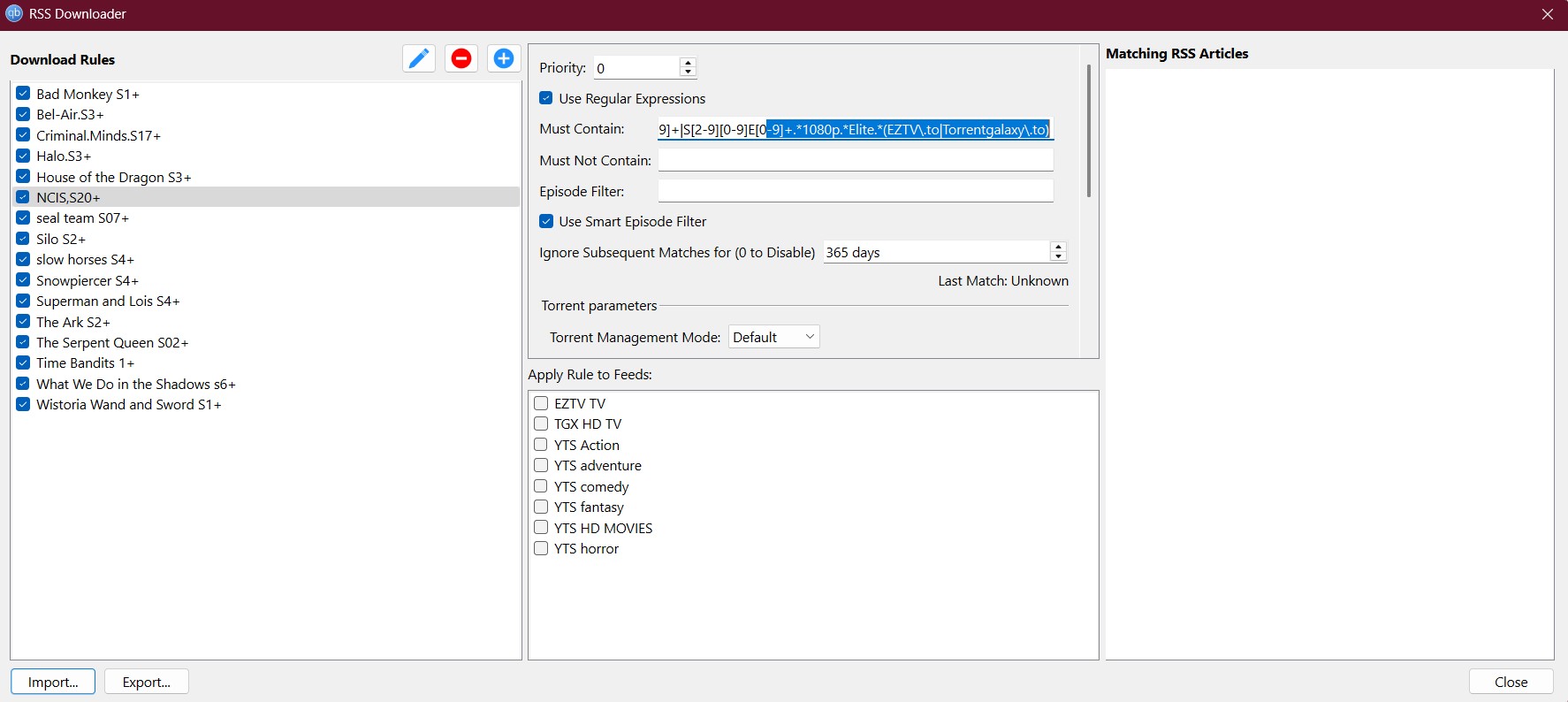

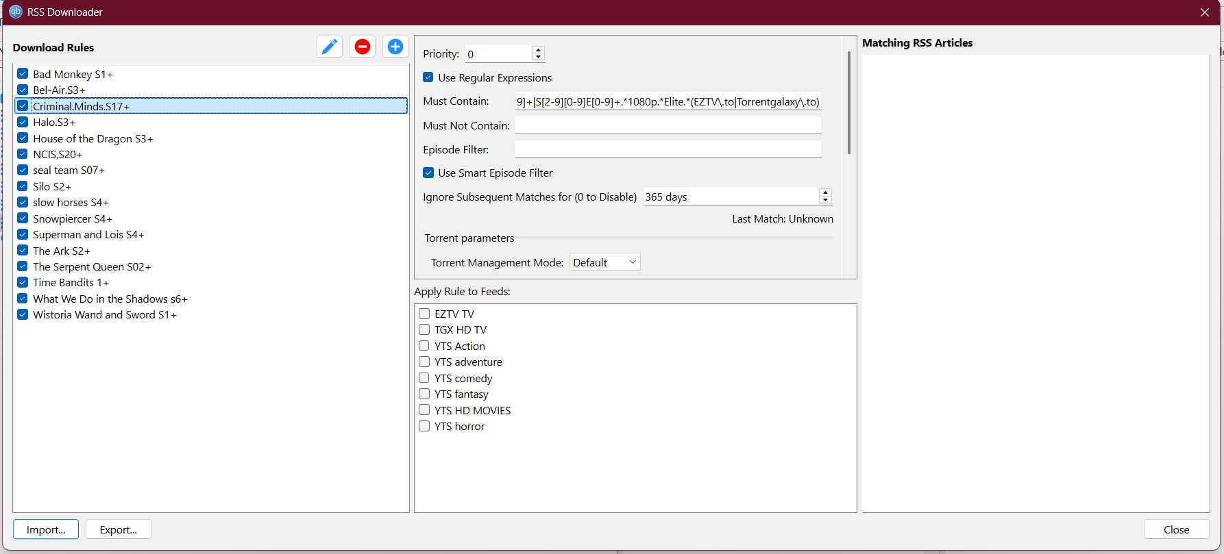

Setting Up RSS Filters in qBittorrent
General Steps:
Open qBittorrent: Launch the application on your computer.
Go to RSS Downloader: Click on the "RSS" icon in the toolbar or navigate to View > RSS Reader.
Add a New Rule: In the RSS Downloader window, click on the "New Rule" button to create a new filter.
Enter the Regular Expression:
In the "Name" field, give your filter a descriptive name.
In the "Must contain" field, enter your regular expression. Make sure to check the "Use regular expressions" box to enable regex matching.
Configure Additional Options: Specify other criteria like "Must not contain," "Episode filter," and "Save to" directory.
Save the Rule: Click "OK" to save your new RSS filter rule.
Specific Regular Expressions:
All Episodes from Seasons 1 to 3:
All Episodes from Season 7 Onwards:
All Episodes from Season 20 Onwards:
All Episodes from Season 3 Onwards:
All Episodes from Season 2 Onwards:
All Episodes from Season 4 Onwards:
All Episodes from Season 5 Onwards:
All Episodes from Season 6 Onwards:
Additional Filters:
Include Specific Uploader:
Include 1080p Quality:
Include Specific Torrent Sites:
Additional Settings:
Smart Episode Filter: Enable this to avoid downloading duplicate episodes.
Ignore Subsequent Matches for X Days: Set this to a number of days (e.g., 7) to prevent downloading the same episode multiple times within that period.
Advanced Tips for RSS Filters
Combining Multiple Filters:
You can combine multiple criteria in a single regular expression using the | (OR) operator. For example, to match either "1080p" or "720p" quality, you can use:
Excluding Specific Patterns:
Use the "Must not contain" field to exclude torrents with certain keywords. For example, if you want to exclude torrents with "CAM" or "TS" (common for low-quality releases), you can add these keywords to the "Must not contain" field.
Episode Filter Syntax:
The episode filter can be very specific. For example, 1-10 will match episodes 1 through 10, and 1,3,5 will match episodes 1, 3, and 5. This can be useful if you only want to download certain episodes.
Using Wildcards:
The .* wildcard in regular expressions matches any character (except for a newline) zero or more times. This is useful for matching any text between keywords. For example, Silo.*1080p will match "Silo" followed by any text and then "1080p".
Case Sensitivity:
Regular expressions in qBittorrent are case-sensitive by default. If you need to perform a case-insensitive match, you can use the (?i) flag at the beginning of your regex. For example:
Testing Your Regular Expressions:
Before applying your regular expressions in qBittorrent, you can test them using online regex testers like regex101. This helps ensure your patterns match exactly what you expect.
Backup and Restore Filters:
You can export your RSS filter rules to a file and import them later. This is useful for backing up your settings or transferring them to another installation of qBittorrent. Go to Tools > Options > RSS and use the "Export" and "Import" buttons.
Regular Expression Resources:
If you're new to regular expressions or want to learn more, there are many resources available online. Websites like RegexOne and Regular-Expressions.info offer tutorials and examples.
Example of a Comprehensive Filter
Here’s an example of a comprehensive filter that matches "Silo" episodes from season 5 onwards, in 1080p quality, from specific uploaders and sites:
Silo.*S0[5-9]E[0-9]+|S1[0-9]E[0-9]+.*1080p.*(Uploader1|Uploader2).*(example1\.com|example2\.com)
This regex will match:
"Silo" episodes from season 5 onwards.
Only 1080p quality.
Uploaded by "Uploader1" or "Uploader2".
From "example1.com" or "example2.com".
I hope this Helps people. I had to sit here and ask copilot millions of diiferent questions to comup with this step by step regex regular expresion guide. in the screenshots put everything like I have it. the regular expression does all the work.
