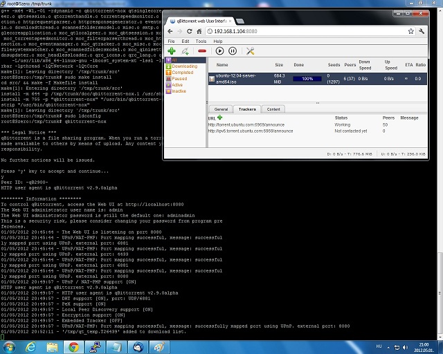

I'm going to add a picture from the result.Very poor.The desktop version much better.So I use rutorrent until the qbittorrent-nox reach the desktop version  quality level.

Brogyi
Re: qBittorrent on ubuntu server - problems during the compilation
Post by Brogyi »
Yes, it worked.This is what you can see on the picture.
