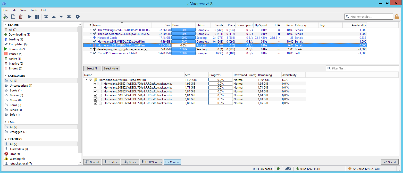

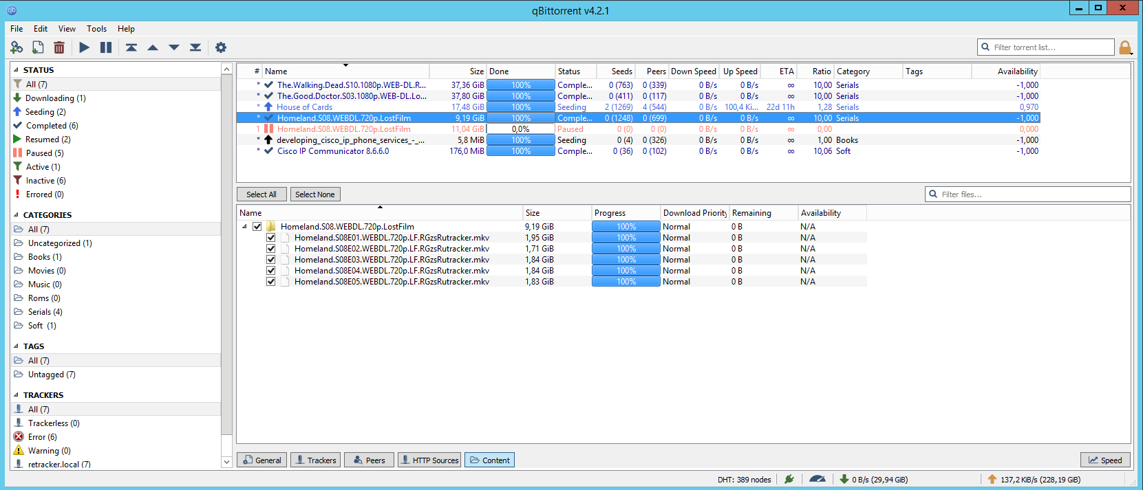

I've made some pictures here, just as an example.
Someone have got a torrent with 5 episodes already downloaded: They update the torrent with 6th episode and release a new torrent file. Someone have downloaded the updated torrent and put it into qBittorrent program: As you can see, when you select the old torrent file qbittorrent "see" all the files downloaded 100%. And when you select the new one, you can see that none of them downloaded. But they are in the same folder except the last 6th episode!
So, if someone delete the old torrent file and press resume on the new one, qbittorrent will download all 6 episodes again. So someone have to recheck it manually, wait until cheeking finish, and THEN press resume... That takes some time and in not good.
So the question was about how to start the new torrent file the way it "sees" all the files already on the disk?
