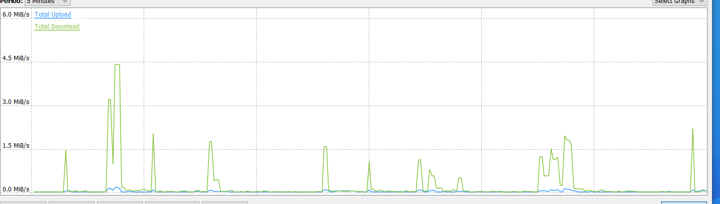

I thought it might be helpful to illustrate the dramatic speed differences between dowload to NAS over LAN and download to a local PC drive with the Qbittorrent speed graphs attached.

Hi beachgrrl.beachgrrl wrote: Wed Apr 01, 2020 4:02 am By way of comparison how does it compare if you save direct to local drive then move it to NAS?
The graph in the prior post illustrates part of that, the torrent save to local drive..
Graph 1 shows the speed when saving Torrent to the harddrive on my PC. Thats running at 6Mbps which is the max I can get with the internet service I have. its fast enough and then to copy over to the NAS is very very fast. It just adds a manual step. .
Graph 2 shows the speed for the identical Torrent download but over the 1G LAN to the Synology NAS. On average its maybe 100x less speed which that odd infrequent burst behavior. So slow its unusable as far as that goes.
As of now the copy to the "save to local drive and copy to NAS approach" is a workaround as you implied but I spent the $ on a quality NAS hoping to streamline and save torrents to the NAS direct.
