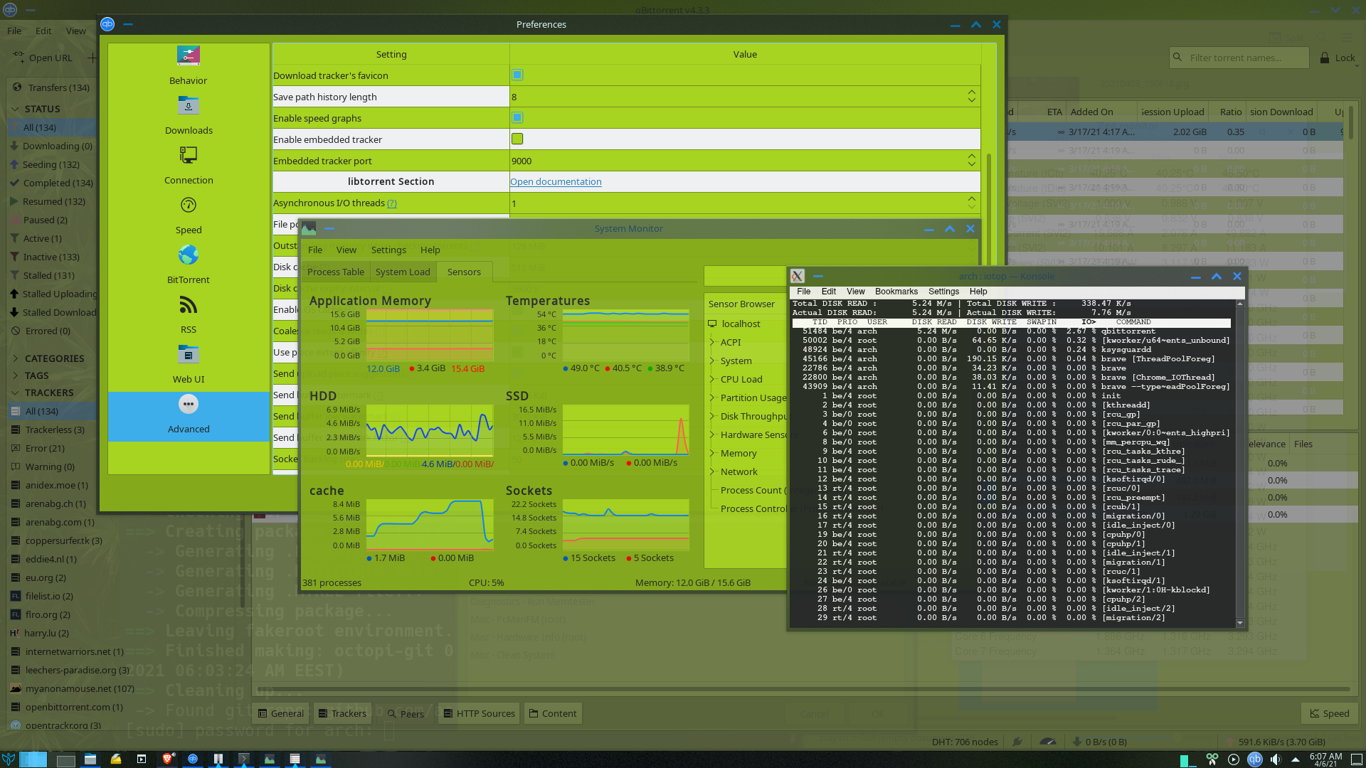

Post by internetaddict24 »
I thought initially that i have too many upload slots or it has a burst speed, but it's neither these, the read rate from the disk really is a few orders of magnitude higher than the upload speed.
I tried fiddling with read cache, disbaling it altogether, setting async_io to 1, nothing worked.
Downloading is perfectly fine.
OS is Arch Linux on 5.11 kernel, IO sched on drives is BFQ, they are formatted as XFS. Tried changing the io scheduler but nothing changed
