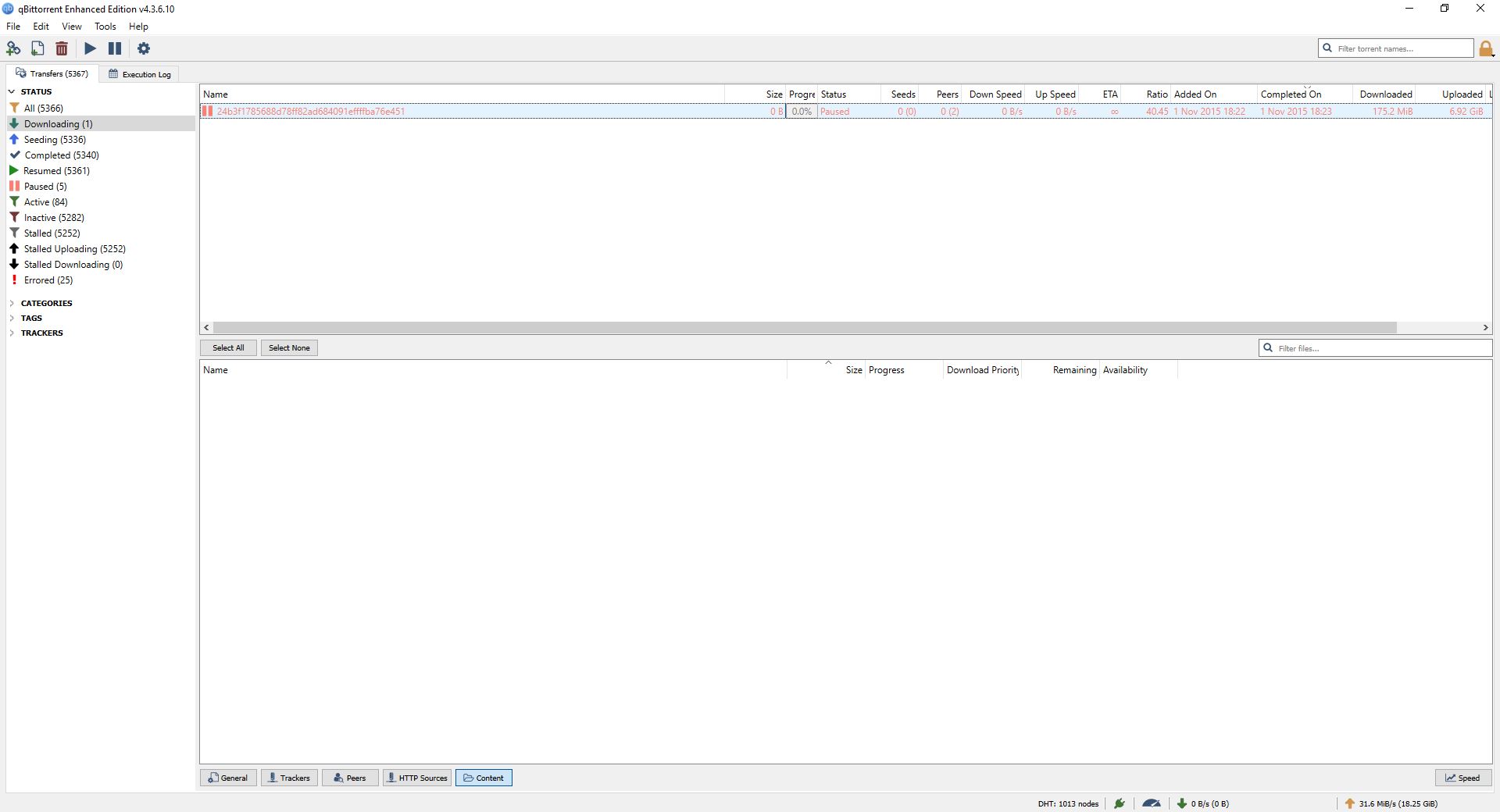

For me,
No AV except for windows defender on both Win10 & Win 11
CPU: Ryzen7 3700X ; Ram: 2x 8gb DDR4 2800Mhz ; OS disk on Win10 is a M2 SSD, but Win 11 is a clone using SATA SSD.
Running storage space with two-way mirror on 2x seagate ST8000VN004 for actual downloads.
qB was running fine until 4.3.7+ which stops working.
Can't really summit a bug tracker on github, because not sure what exactly is the issue.
Memory usage is around 1.5k - 2k and internet speed is being bottlenecked by the AV2000 powerline, so all seems fine there.
Not sure is it related, I do have this ghost entry issue since 4.3.x.
4.2.1 & 4.2.5 are also running fine for me, but not the in-between versions.
Cant really recommend 4.1.x because of the saving torrent issue and the even worse crush on startup issue.

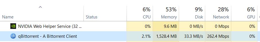

- Ram usage
- Capture5.JPG (28.78 KiB) Viewed 8653 times
- Quick screenshot for demo only. I do use the official version when testing the new versions
- Capture.JPG (117.89 KiB) Viewed 8653 times
Re: Freezing on 4.3.8 and 4.3.9
I mean if it's the ram usage, that seems like an IO bottleneck.
You can check actual ram usage with "rammap" from Sysinternals. RAID1 for writes is slow as hell. The only way to make it "livable" is by using a Raid controller with RAM cache. Without that, Windows will just use your ram to cache the writes since the array can't keep up. There are programs like Primocache for Windows, but they just delay writes potentially causing data loss (on power loss, BSOD, etc.)
