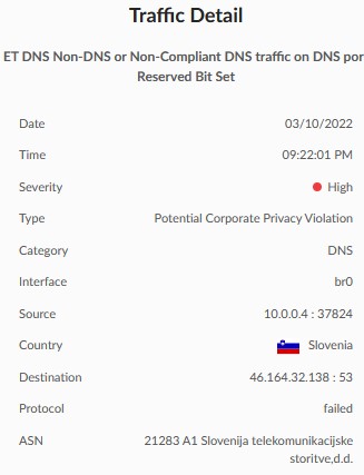

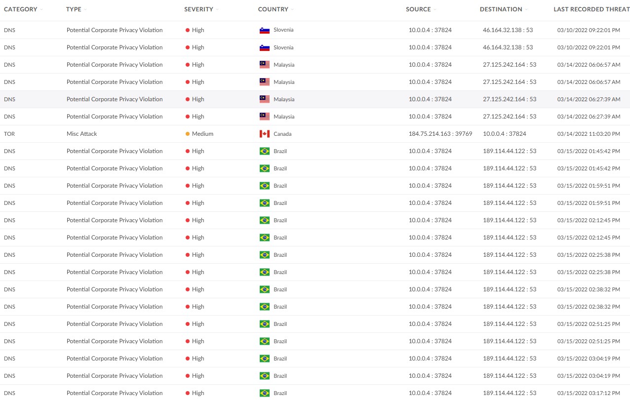

I'm getting alerts from my firewall about suspicious connection attempt to an external server on port 53 (this is usually a DNS server port). This is repeating roughly every 10mins and I have confirmed it is definitely qbittorrent doing make these connections. I'm running the current version of qbittorrent on my linux server and there is nothing in the queue.
I have attached 2 screenshots from my router console. One pic shows the list of alerts the other shows more details of one alerts.
What is going on? Why is qbittorrent doing this when the queue is empty?

- eample details.jpg (20.84 KiB) Viewed 1742 times
- Alerts List.jpg (199.15 KiB) Viewed 1742 times

qBittorrent like many clients is maintaining a P2P "DHT" network.
https://en.wikipedia.org/wiki/Distributed_hash_table
To disable this, go into Settings -> Bittorent, and you can disable DHT there.
Is it a real threat? I doubt it. I think it's just the firewall being.. well, awful. IMO the "firewall" is junk and you should uninstall it.
