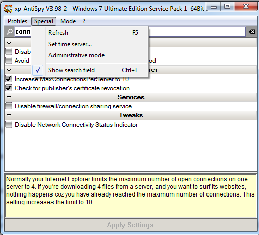

@Tomaso
I did as you suggested and there doesn't appear to be the option you are talking about??

Re: Qbittorrent soaking all of the bandwidth?
Oh, I'm running WinXP myself, so I haven't encountered that problem.
Seems that in WinVista (maybe in Win7 too) you need to click 'Special' > 'Administrative mode', and restart the program first, to access that setting.
