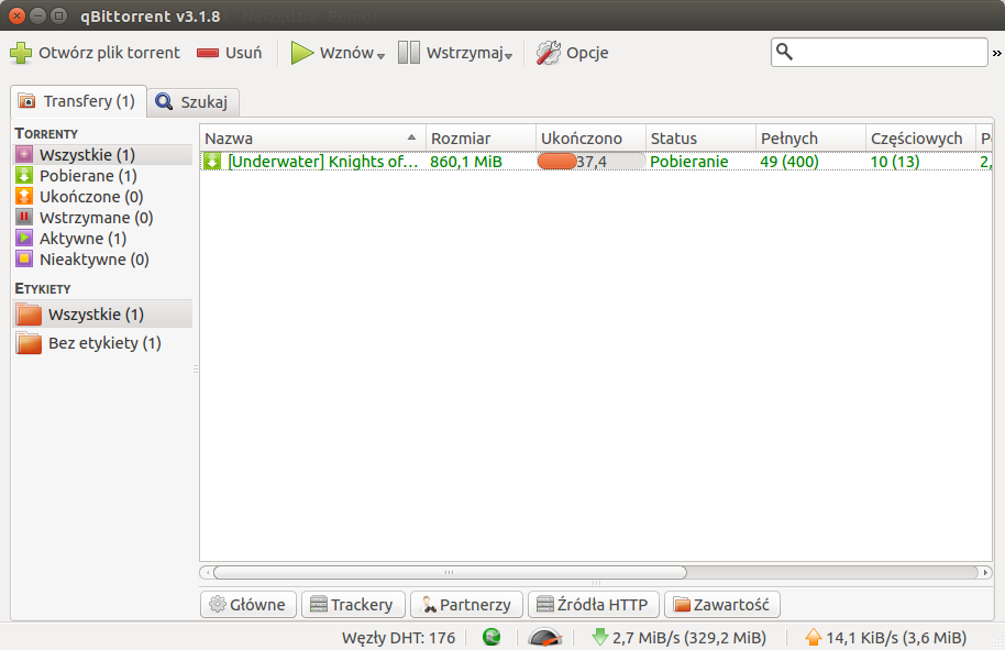

Having now looked CLOSELY at the screen shots, you are loading two different types of payload.
One is a single file which does NOT show a file list on the "Add new dialogue"  the second is a multiple file which does show a file list.

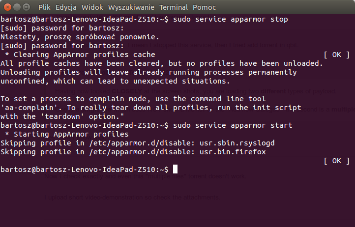

[quote="Peter"]
Try this from a Terminal:
$ sudo service apparmor stop
Then try restarting qBittorrent, and loading your torrent.[/quote]
I do that but nothing happen. I mean I stopped this service, then I tried add torrent in qbit.
[quote="ciaobaby"]
One is a single file which does NOT show a file list on the "Add new dialogue"  the second is a multiple file which does show a file list.[/quote]
Yes, now I know that.
Now I check exactly and even this "multiple files" torrent doesn't work.
