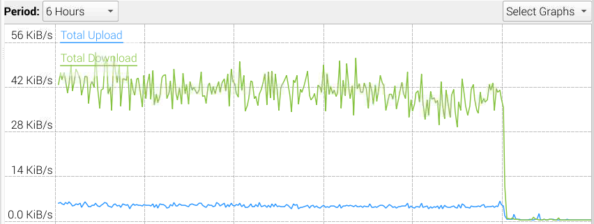

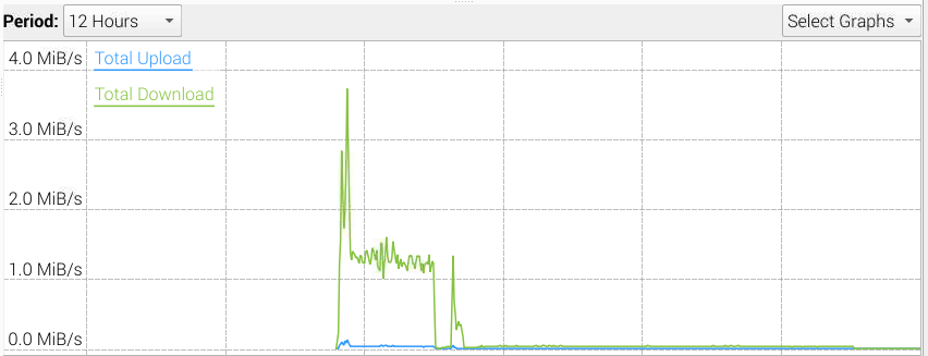

Issue: Speed starts out fine at ~2MB/s. Then after a while (1-2 hours) speed drops to 40KB/s, and then later one it might drop even more. See attached pictures.

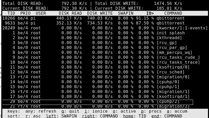

Ok, this is rather interesting. After closing qbittorrent in the gui, I ran iotop, and it seems to be reading and writing? Why? See attached photo.

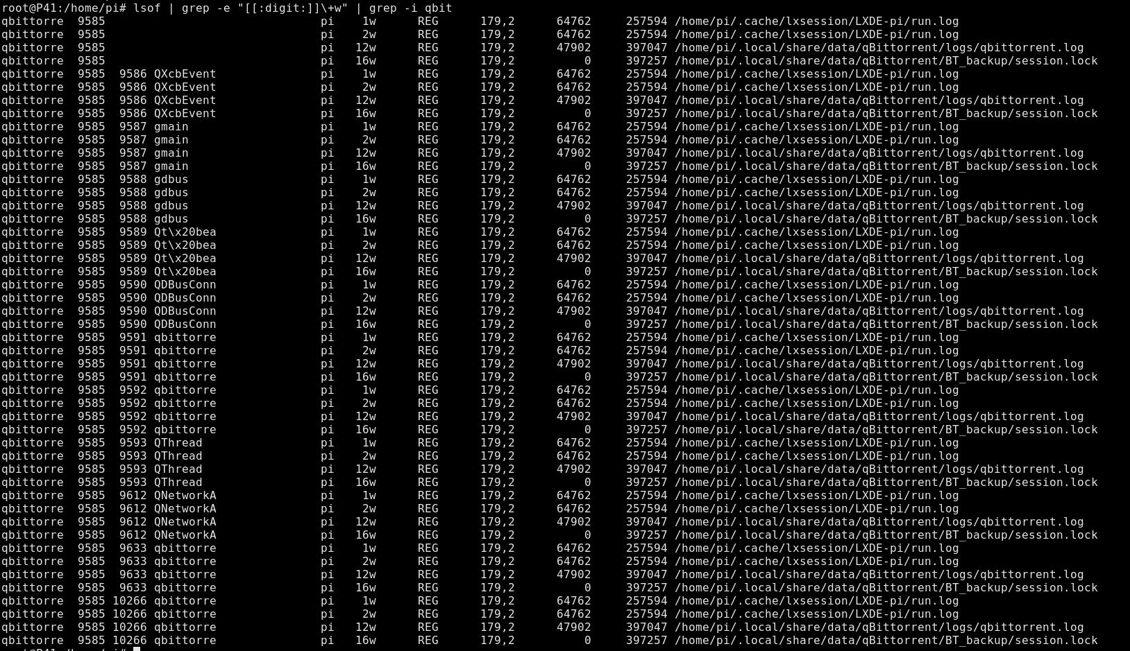

Attached lsof..
