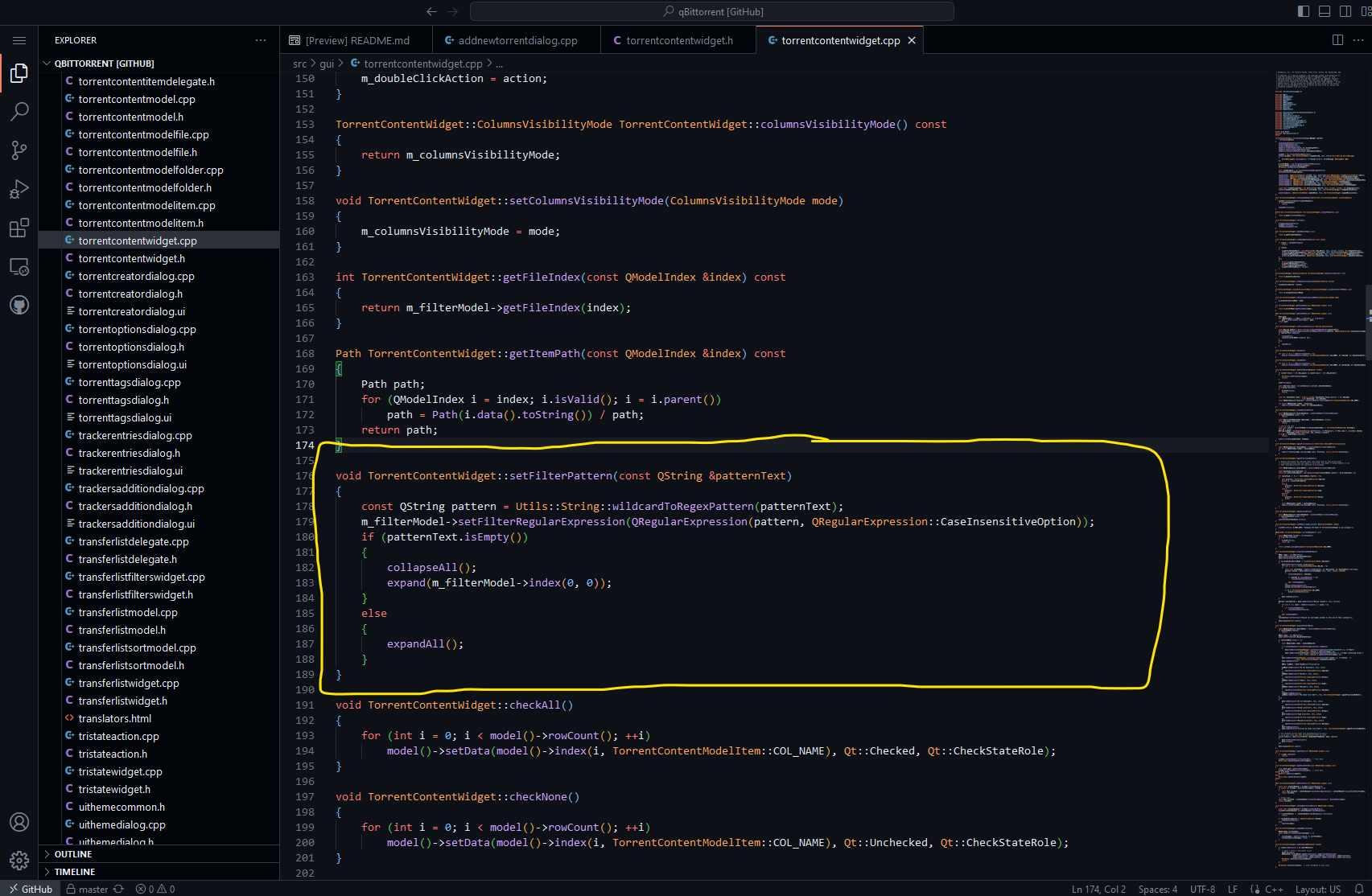

I think the search box IS regex. I tried messing around to find a solution for you but I don't have an example torrent unfortunately.
Like..
Screenshot 2023-11-12 132600.png (288.66 KiB) Viewed 3064 times
To my understanding, that should be regex. Should be... if it's not a super secret torrent, feel free to PM it to me?
