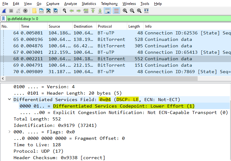

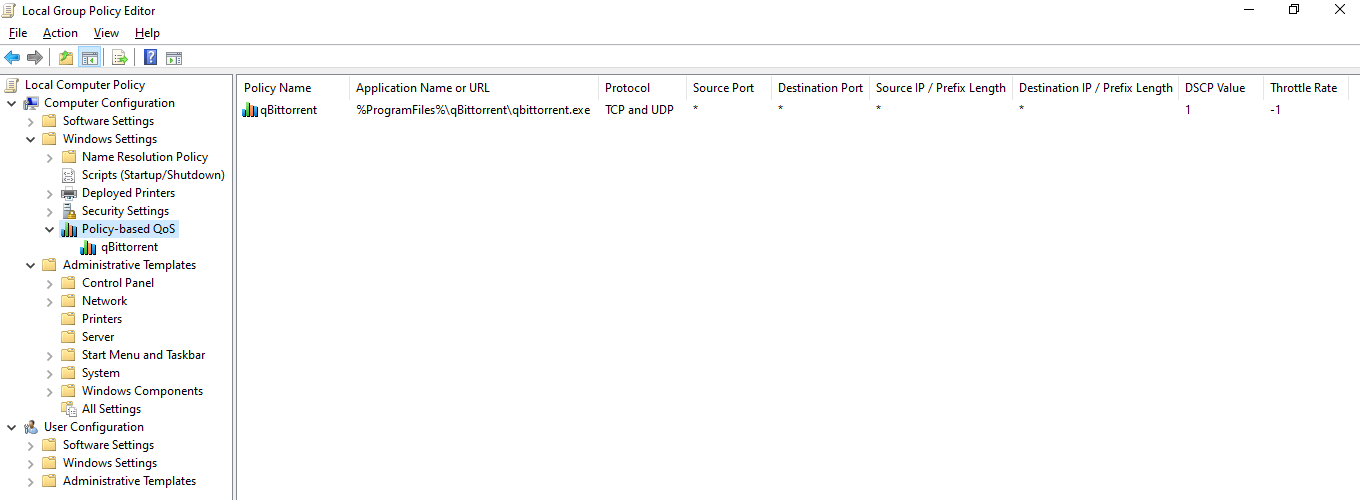

On a final note you can override apps that set their own DSCP markings, and prevent Windows from clearing them, through policy-based QoS in the Group Policy editor. If this actually is a bug in the qBittorrent client then this will resolve it by letting you force DSCP 1 → Enable DSCP QoS Tagging on Windows Machines. You can also set DSCP values on each individual network adapter inside the registry, through PowerShell cmdlets, or programmatically with Windows' respective QoS API. As an experiment I just captured hundreds of thousands of packets while downloading a torrent. I configured the display filter in Wireshark to only show DSCP tagged packets (ip.dsfield.dscp != 0). The result was as expected, only a fraction of the total traffic, both inbound & outbound, contained markings. I observed over a half-dozen DSCP markings from different peers in the swarm with 0 (unmarked) being by far the most prevalent. No surprise there since it's the default ‘Best Effort’ (BE) classification after all.
Local Group Policy
Local Group Policy
Packet Capture
Packet Capture
