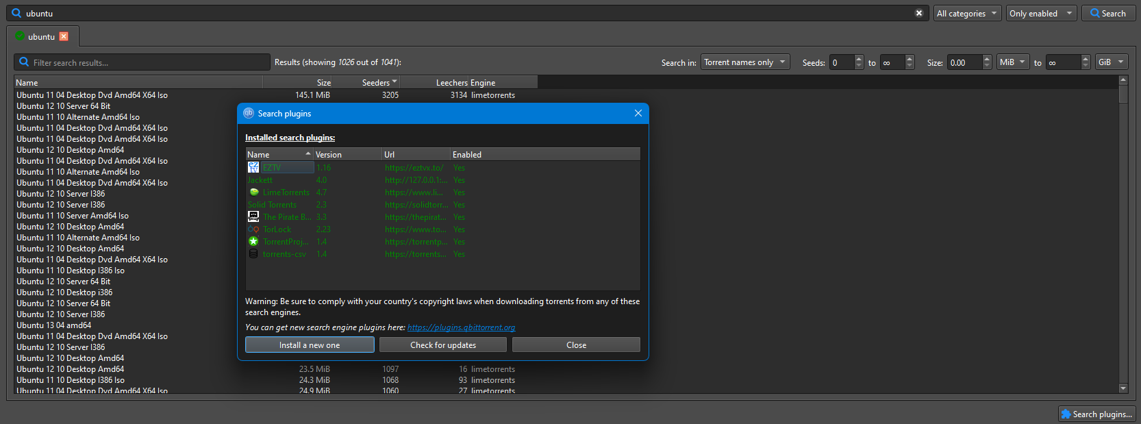

Not correct. I clicked Search for updates and all the plugins function fine.

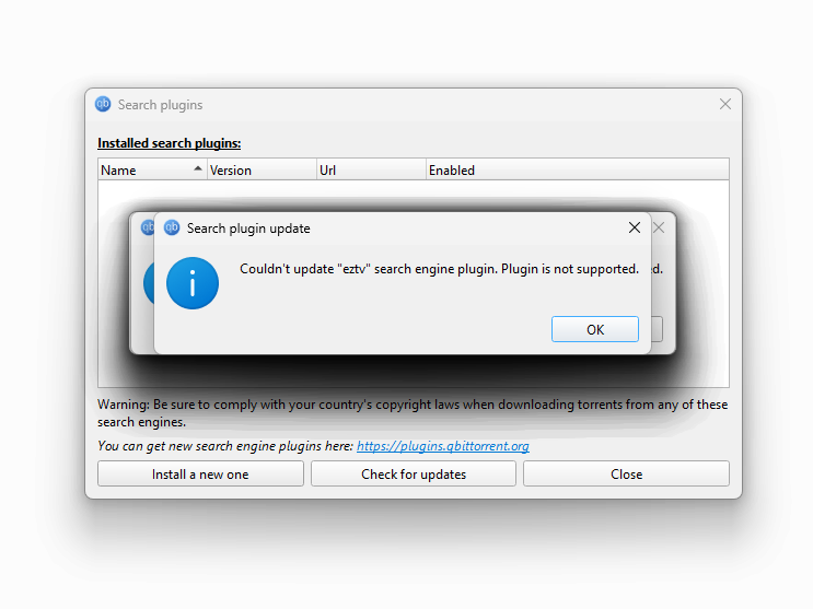

And I did a search for plugin updates and received "plugin is not supported" for every one of them. I also downloaded new python files and received the same message when trying to add them.
Screenshot 2024-09-30 084329.png (59.18 KiB) Viewed 26660 times
Re: Search plugins for 5.0?
On Reddit they said you might have an incompatible plugin that broke things. Tokyotoshokan is one of such.
They are here: %LOCALAPPDATA%\qBittorrent\nova3

Peter wrote: Mon Sep 30, 2024 12:57 pm On Reddit they said you might have an incompatible plugin that broke things. Tokyotoshokan is one of such.
Deleting Tokyotoshokan fixed the problem for me. I am with Python-3.12
Thanks for reporting that @Peter
