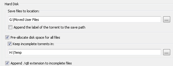

JohnDoe21
Re: Incomplete downloads aren't loaded on check or force recheck.
Post by JohnDoe21 »
[quote="sledgehammer_999"]
1. To be sure of the location check "save path" in the "general" button. Does it point to the correct path?
2. Do you have enabled the "keep incomplete torrents in" functionality in options?
3. Go to the bt_backup folder(after you closed qbt) and copy the .torrent and .fastresume file of the problematic torrent. (the name matches its infohash). Then zip them up and pm them to me.

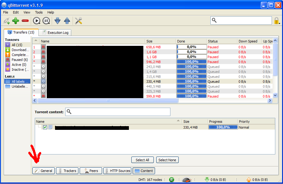

1. I don't see a general button. but see the attached .jpg.
2. Yes, see attached .jpg for proof.
3. Ugg, I'd prefer not to be sharing my torrent files if I don't have to as I am most positive it isn't the torrent, it's either the saved file or something in qBt. But for future's sake where would I find this backup folder?
See attached image.
