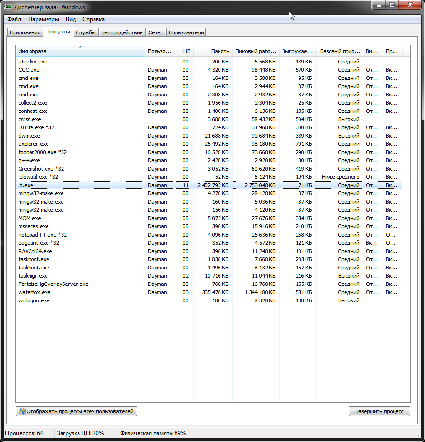

Conclusion: lto reduces binary size by around 15%. A lot of flags do not work in gcc windows port (flags taken from http://wiki.wxwidgets.org/Reducing_Executable_Size and man ld)

Also: Building Qt with -flto -fuse-linker-plugin -fwhole-program in attachment.
[me=Dayman]remembers building wxWidgets monolithic library with gcc. 3 Gigs ate by ld and can't allocate memory comes next. I hope current mingw versions are built with LARGEADDRESSAWARE in mind.[/me]
