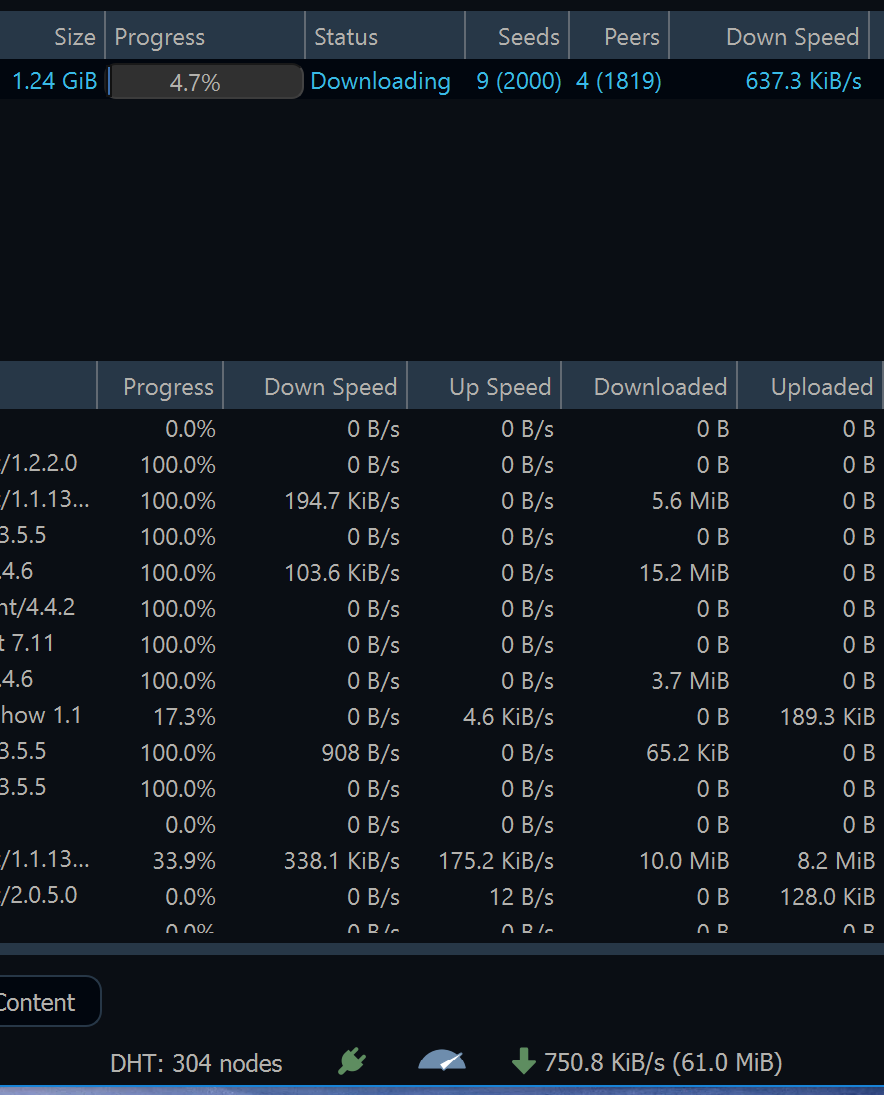

Is this normal or do I have something wrong in my settings or network? See screenshot for context. I have unlimited cap in settings for upload/download and the connection plug at the bottom is green. Why are there only 9 peers that I'm downloading from out of 2000? Even DHT shows over 300 nodes. Is this simply how the system works and I need to be happy I get anything (lol)?

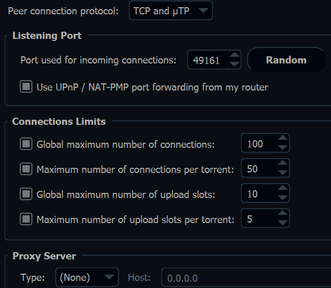

Options > Connection > Connection Limits. What are these numbers?
mushu
Re: What am I doing wrong, 2000 seeds only 9 connections?
Post by mushu »

On the trackers tab on the main screen (bottom left). Confirm that the number of seeds and peers match the numbers of seeds and peers in brackets on the main screen.
This had been a bug for a long time, but was supposedly fixed in v4.5.0.

This is not a good swarm.
Peers are NOT seeds. Yes in theory everyone should seed but it's never like that. This looks like a public torrent swarm, or a fresh torrent on a private tracker. Meaning the seeders are pretty saturated. Each peer only has a set amount of upload speed, and upload slots. If those are taken, you simply won't connect to them.
There are other things too. They might not be able to connect to you for whatever reason (peerblock, ISP blocking your subnet, you blocking them, etc.)
