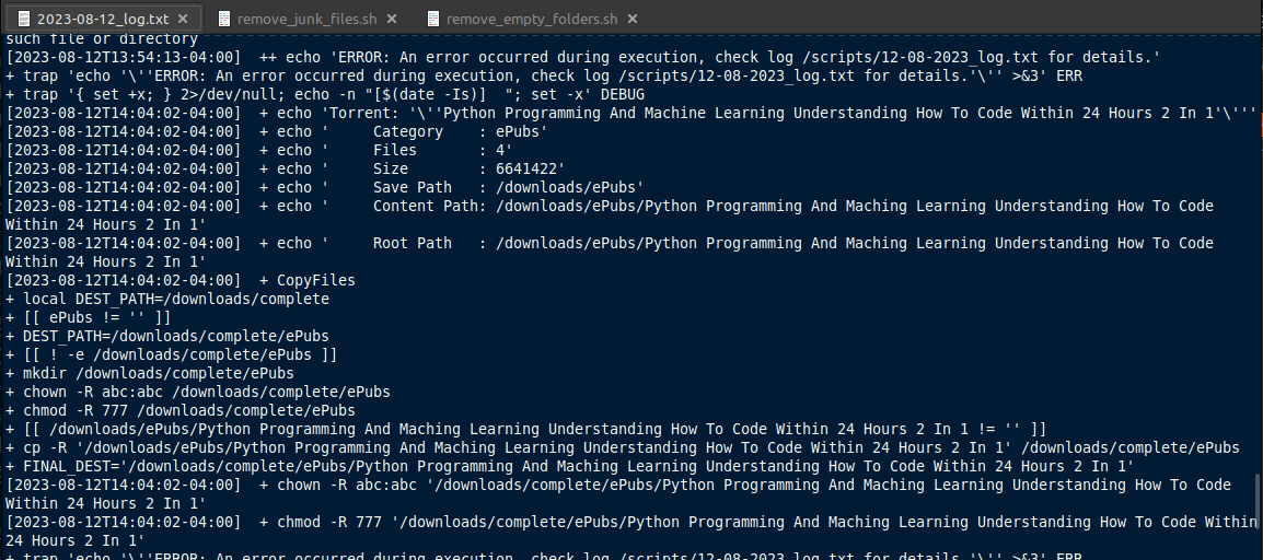

iRobot73
Re: "Run external program on torrent completion" is not working
Post by iRobot73 »
I cobbled a .SH to move things around upon completion (allowing seeding of the original files to 1:1, then deleting the files). Took a bit of trial-n-error
'Upon completion' (add/remove as you want/need):
/bin/bash /scripts/complete.sh -n "%N" -l "%L" -f "%F" -r "%R" -c "%D" -c %C -z %Z -i "%I" -j "%J" -k "%K"
Updated the process to use flags so order passed to script won't matter
Been keeping track of all iterations via GitHub
Outputs all the parameters for easy validation/tweaking. Not the prettiest output but, IMO, easy enough to follow
[2023-08-12T13:54:13-04:00]  ++ echo 'ERROR: An error occurred during execution, check log /scripts/12-08-2023_log.txt for details.'
+ trap 'echo '\''ERROR: An error occurred during execution, check log /scripts/12-08-2023_log.txt for details.'\'' >&3' ERR
+ trap '{ set +x; } 2>/dev/null; echo -n "[$(date -Is)]  "; set -x' DEBUG
[2023-08-12T14:04:02-04:00]  + echo 'Torrent: '\''Python Programming And Machine Learning Understanding How To Code Within 24 Hours 2 In 1'\'''
[2023-08-12T14:04:02-04:00]  + echo '     Category    : ePubs'
[2023-08-12T14:04:02-04:00]  + echo '     Files       : 4'
[2023-08-12T14:04:02-04:00]  + echo '     Size        : 6641422'
[2023-08-12T14:04:02-04:00]  + echo '     Save Path   : /downloads/ePubs'
[2023-08-12T14:04:02-04:00]  + echo '     Content Path: /downloads/ePubs/Python Programming And Maching Learning Understanding How To Code Within 24 Hours 2 In 1'
[2023-08-12T14:04:02-04:00]  + echo '     Root Path   : /downloads/ePubs/Python Programming And Maching Learning Understanding How To Code Within 24 Hours 2 In 1'
[2023-08-12T14:04:02-04:00]  + CopyFiles
+ local DEST_PATH=/downloads/complete
+ [[ ePubs != '' ]]
+ DEST_PATH=/downloads/complete/ePubs
+ [[ ! -e /downloads/complete/ePubs ]]
+ mkdir /downloads/complete/ePubs
+ chown -R abc:abc /downloads/complete/ePubs
+ chmod -R 777 /downloads/complete/ePubs
+ [[ /downloads/ePubs/Python Programming And Maching Learning Understanding How To Code Within 24 Hours 2 In 1 != '' ]]
+ cp -R '/downloads/ePubs/Python Programming And Maching Learning Understanding How To Code Within 24 Hours 2 In 1' /downloads/complete/ePubs
+ FINAL_DEST='/downloads/complete/ePubs/Python Programming And Maching Learning Understanding How To Code Within 24 Hours 2 In 1'
[2023-08-12T14:04:02-04:00]  + chown -R abc:abc '/downloads/complete/ePubs/Python Programming And Maching Learning Understanding How To Code Within 24 Hours 2 In 1'
[2023-08-12T14:04:02-04:00]  + chmod -R 777 '/downloads/complete/ePubs/Python Programming And Maching Learning Understanding How To Code Within 24 Hours 2 In 1'
