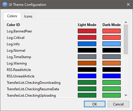

The most recent update v4.6.0 (Oct 22th 2023) now has something called the "UI Theme Configuration", allowing the customisation of the default theme: Options → Behaviour → Interface → Customize UI Theme...
The customisation panel presents a list of colours and icons for both a "Dark Mode" and a "Light Mode".
However, where exactly does one enable the "Dark Mode"?
UI Theme Configuration.png (10.39 KiB) Viewed 160451 times

Where exactly does one enable the "Dark Mode"?
In your Windows Settings you have to enable it first.
There's no dark mode button in qBit v4.6.0, even current latest v5.0.0alpha1 experimental development build doesn't have such button and qBit relies on dependency Qt6 library to get and use more native OS theme automatically and immediately without requiring to restart qBit to see some changes to qBit interface. Otherwise too much unnecessary code to test and maintain if have to bundle extra theme files or to try to use workarounds instead of allowing Qt to be responsible for qBit theme changes.
You can currently only specify icons and text colors in v4.6.0, even latest v5.0.0alpha1 doesn't allow specifying background color without modifying code or without using any custom theme file.

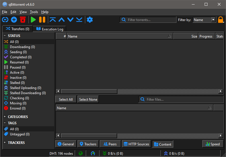

This is how I got qBit v4.6 Dark Mode in Win11:
1. Enable dark theme in Windows OS settings.
2. Make sure you disable custom theme in qBit.
3. Exit qBittorrent and make sure it's fully closed.
4. Now try running qBit with one of these:
Right-click on your Windows Start Menu icon, then select RUN, then copy and paste the default qBit location with the extra command and press OK:
"C:\Program Files\qBittorrent.exe" -platform windows:darkmode=2
Alternatively, you can modify qBit shortcuts:
Open Start Menu, right-click on the qBit shortcut, select to open its location, now right-click on the shortcut file, right-click on it, click properties, and then change Target field to: "C:\Program Files\qBittorrent\qbittorrent.exe" -platform windows:darkmode=2
Or on desktop, copy your qBit shortcut, rename it as qBit Dark Mode, then right-click on it, select properties, and then change the Target field to: "C:\Program Files\qBittorrent\qbittorrent.exe" -platform windows:darkmode=2
CarFMI
Posts: 3
Joined: Mon Oct 23, 2023 12:55 am
Re: How to enable dark mode in v4.6.0 UI Theme Configuration?
Post by CarFMI »
Thank you very much for the detailed answer.
As for your various steps ...
  1. Yes, I already had Windows in dark mode.
  2. Yes, I had already disabled the theme I was using before, because it does not work on v4.6.
  3. Done.
  4. Update the shortcut with the extra command line parameter, as per your instructions.
It is now working splendidly in "Dark Mode". Thank you!

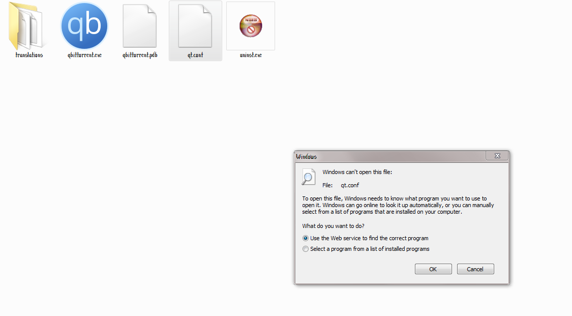

So enabling Dark Windows theme in Windows Setting doesn't affect my qBittorrent color. Although enabling dark mode by launching with command line or editing link works pretty well.
BUT! If I'm opening torrent file, when qBit not launched, it still white. So, I have better solution. You can edit "qt.conf" file instead of modifying link. If's sit beside to qBittorrent.exe ("c:\Program Files\qBittorrent\" for me)
Open qt.conf file for editing (administrative privileges would required).
In the end of file, add following line:
WindowsArguments = darkmode=2
Save file. After relaunching qBit it would be dark mode enabled. Works even if you launching qBit though opening torrent file.

How do you do that? Mine won't let me, even with admin privs

In first place, your windows actually let you to choose the program, by second option:
* Select a program from a list of installed programs.
Then click Ok button, and locate notepad.
There is several ways how to launch notepad with admin privileges.
Launch notepad. Press Ctrl+Shift+"Left mouse click" on Notepad app icon in the taskbar.
It should prompt dialog to run new application instance with administrative privileges.
Or.
Open Windows "Start" menu. Locate notepad. Right mouse click on it, and choose "Run as administrator".
After that you can open qt.conf from "File/Open" dialog (don't' forget to change "Text document (*.txt)" selector to "All files (*.*)")
Open qt.conf file in administrative instance of app. Add the dark mode enabling line to qt.conf and save file.
And last option.
Save following as qt.conf file (not qt.conf.txt one!)
[Paths]
Translations = translations
[Platforms]
;WindowsArguments = dpiawareness=1
Copy that file, and paste it in qBits folder in Program files using Explorer. Explorer would ask you, about administrative privileges in order to replace original one.

I tried this, it didn't work.
idimus
Posts: 5
Joined: Fri Jan 19, 2024 9:04 pm
Post by idimus »
You have windows 7?
SinShadowFox
Posts: 15
Joined: Thu Aug 05, 2021 2:42 pm
Post by SinShadowFox »
idimus wrote: Sat Jan 27, 2024 4:45 pm You have windows 7?
Yes.
