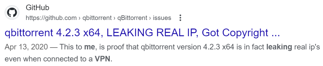

If you're running your VPN client on the same host make sure that you explicitly bind qBittorrent to your VPN interface. This will ensure that no torrent traffic leaks. Unfortunately many other torrent clients don't have this handy feature. If you do occasionally use any of them then you can configure it to connect through a SOCKS5 proxy server (use a private one that requires auth). You could also configure it system-wide but then it'd slow everything down. The proxy will provide an additional layer of protection in the event that any torrent traffic does leak outside the tunnel. Just remember to always force protocol encryption since SOCKS itself doesn't have native support. Side note: qBittorrent's I2P integration looks promising but it's still considered experimental.

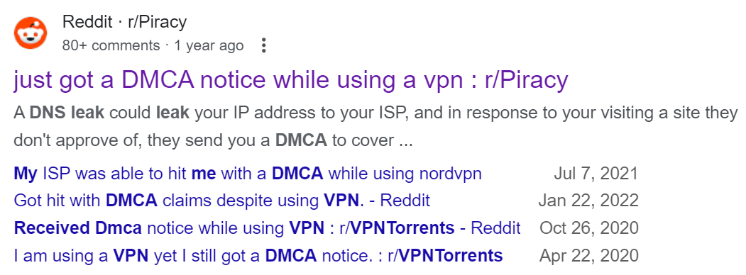

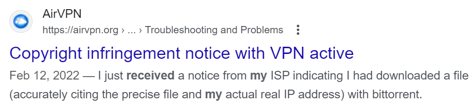

This usually means that your DNS queries were inadvertently sent to your ISP outside the tunnel. Alternatively, if you've manually set 3rd party public DNS servers (ieg., Cloudflare, Google Public DNS, OpenDNS…), it means that your DNS traffic was sent outside the tunnel and ‘in the clear’ (unencrypted) to their recursive resolvers. In either case your origin IP is exposed, which reveals your identity & approximate location, along with your data. If using public DNS make sure that your queries are always encrypted (ieg., via DoH, DoT, DoQ, DNSCrypt…) and manually configure it with global scope if possible depending on your platform. By encrypting your public DNS queries it will protect them in transit on the back segment after they've left the tunnel. Additionally, if your DNS traffic were to leak outside the tunnel, then your ISP or government wouldn't be able to intercept or hijack it via a transparent proxy or DPI appliance. Ideally your DNS provider should also deploy DNSSEC to protect the resource records themselves. Another thing you should do is ensure that your setup doesn't fall back to insecure DNS if encrypted DNS resolution fails. Lastly, avoid setting DNS at the application level (ieg., inside your web browser). It was never intended to be used there and is easy to forget about.

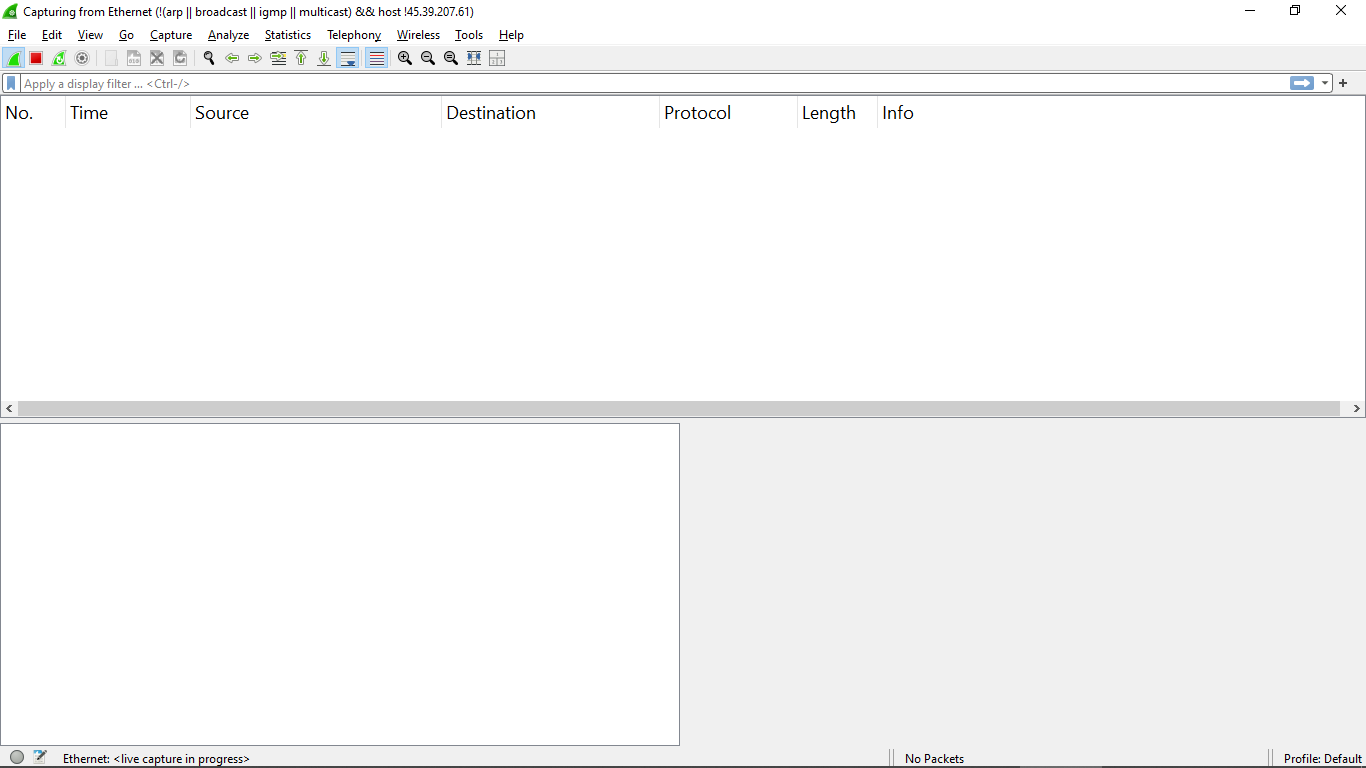

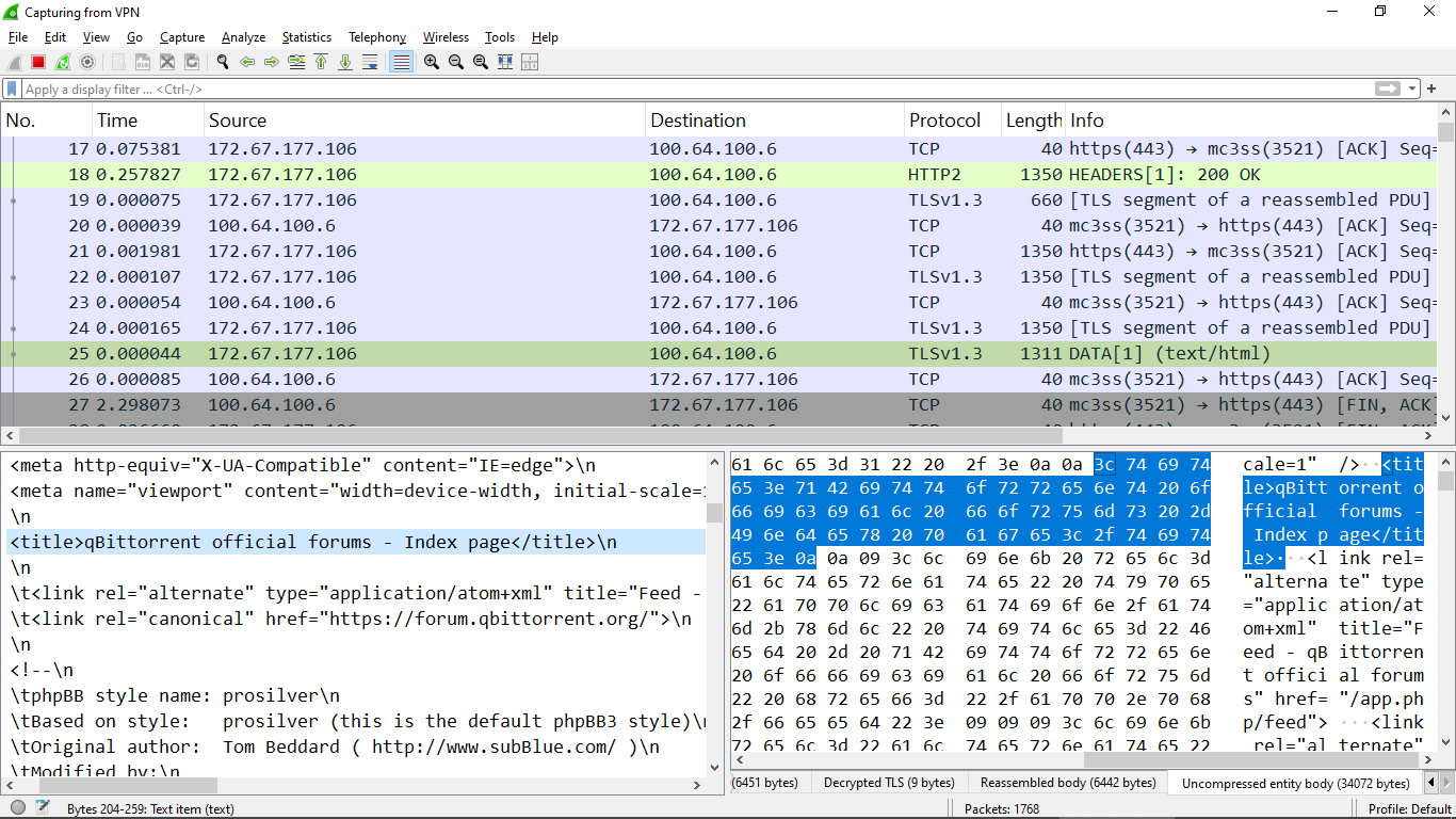

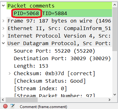

If you suspect that your VPN may be occasionally leaking traffic then it's worth investigating. It isn't difficult to verify yourself. Just start a live packet capture session on your device and monitor your physical NIC for your Ethernet/Wi-Fi internet connection. If you plan to keep it on then you'll either want the sniffer running as a background app/service or in the form of a lightweight console app (ieg., TShark, tcpdump, …). Configure your capture filters appropriately for all of the different types of traffic present on your network. Contrary to popular belief Windows provides built-in packet capture. There are at least 4 different ways to do it (pktmon, netsh trace, netmon which still works but was discontinued, and a mixture of PowerShell Net Events cmdlets). That said, I prefer using flexible 3rd party tools like Wireshark/TShark for capture & display. It has a tremendous number of protocol dissectors for traffic classification & inspection. My capture filter looks like this. It will only catch leaked traffic 99.99% of the time. Not bad for such a simple expression.
!(arp || broadcast || igmp || multicast) && host !45.39.207.61
As you can see, I've had no leaks today. 8)
If any traffic ever did somehow manage to leak then I'd not only be aware of it I'd also know which apps' traffic bypassed the tunnel. Some packet sniffers can map network communication to process identifiers (PID). It can certainly come in handy. For example, the netsh trace & pktmon commands on Windows have it built-in. If your sniffer doesn't support this functionality then you could simply start a live capture with either of the aforementioned commands and then use a separate app like Wireshark to actually display the packets. Once you have the socket owner's respective PID you can simply open taskmgr and under the Details column it'll list them for every process. Alternatively you can spawn an elevated command prompt and run netstat -aboqv or similar as long as the -b & -o switches are included.
Wireshark can also be used to do lots of other cool stuff. Notice that not only am I sniffing my VPN's virtual interface (some VPN users cannot do this) I'm also decrypting my browser's SSL/TLS traffic in real-time. Network visibility is essential. In the example below it's my active HTTPS session on this site which is being protected by the latest version of TLS 1.3.

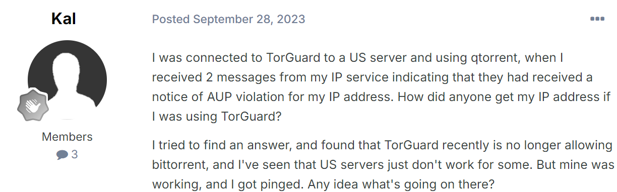

Speaking of the TorGuard service the person below was using their VPN client on the same device while torrenting copyright protected material and got nabbed. He's a qBittorrent user. Most leaks we hear about are software VPN leaks with the VPN client running on the same device as the rest of your apps. Had he been running TorGuard on his router then this wouldn't have happened. All of his outbound traffic would've been forcefully encapsulated, encrypted, and authenticated to the VPN server even if qBittorrent wasn't explicitly bound to his VPN's interface. It's nearly impossible for any traffic to ever sidestep it. The default setting in qBittorrent is to use any available network interface. Ultimately the blame is on TorGuard's VPN client. It obviously failed to protect his torrent traffic since it was able to bypass the tunnel.
Received a copyright violation while using TorGuard
