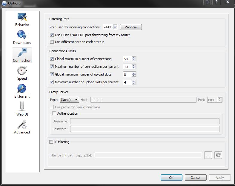

I intend to maximize my upload speed which is very low at the moment, as regarding these setting, I have them like this:
Global maximum connection - 500
Maximum number of connections per torrent - 100
Global maximum number of upload slots - 8
Maximum number of upload slots per torrent - 4
Bottom line is that I would like to improve my upload speed in qbittorrent. I was using uTorrent before (about a month ago) and I saw upload speeds as high as 8-10 mb/s. I uninstalled utorrent and wanted to start using qbittorrent, but the highest upload speeds I have seen so far was 1mb/s, but that was just an isolated incident, mostly I see upload speeds below 100 KiB/s. Also with utorrent I had tens of torrents being uploaded simultaneously, while with qbittorrent I have seen a maximum of 5 simultaneous uploads. My internet speed or firewall settings hasn't been changed, I don't have access to ISP's "internet box", nor did I have it while I was using utorrent. The only change I had is torrent software.

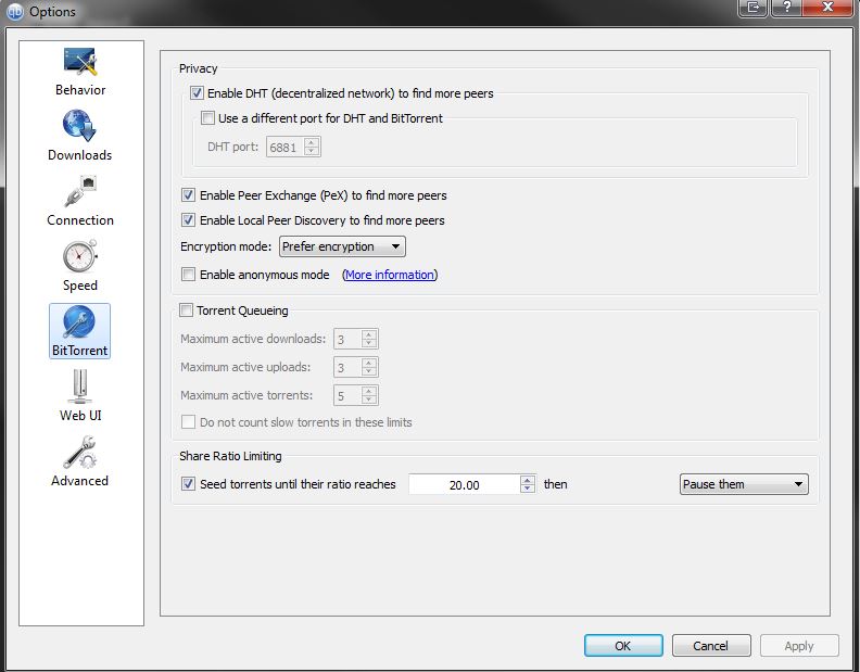

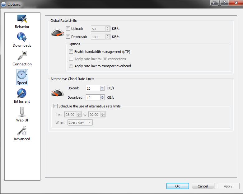

I've uploaded some screenshots of my configuration
Version I'm running is 3.1.11
I understand that ultimately it comes down to how fast peers can download from me, but so far it seems that my internets full potential isn't being used.

So max DL rate of around 100 KiBps as a starting point, max UL 80KiBps
You don't give any idea of how many jobs you expect to run or what kind of swarms they are likely to have  but "maxing the upload" is NOT a basis for useful setting.
so at a guess and assuming you are not a "power" user:
300 global connections, 8 or 10 per torrent with 5 or 6 upload slots to start with. Then you start to monitor and test with varying jobs ang juggle around with the connection.
You don't say whether it is a shared machine (also used for browsing, email etc.) or whether it is for qbittorrent only so I have no idea whether you could/should test with more connections or less initially
Set half-open connection to less than 10,  you may get away with more but that depends on your OS.
You may need to disable IPv6 but that also depends on the OS.
Set uTP on and rate limit uTP on, again this is something else you need to determine depending on your use case

I've never enforced any upload on download restrictions. May I ask why are you suggesting such little speeds? Maybe I told something wrong about my speed before, I was referring to Megabits in my previous post but here is a link with my speed results in Kilobytes - http://www.speedtest.net/my-result/3982427360
At the moment I have 50 torrents (all of them are finished), but most of them are inactive (no upload). I download something from time to time, but usually torrents are finished and ready for upload, on average I would say I have around 30-40 torrents in my program.
I am the only user of this particular PC, torrent application usually runs in background while the computer is on. I can test freely. I have yet to experience a situation where I would need to limit download or upload speed. And if situation like this would occur, I would just quit torrent application for the time being.
I'm probably not a power user, but I do know my way around PC and windows (I'm using windows 7 64bit version). I'm just not too familiar with torrent settings.
How much should I set in "Global maximum number of upload slots"?
I really couldn't find where to set "half-open connections"
Isn't uTP something that limits speed?

Expecting that you're router settings etc. is as should be. I'd set something like.
I'm using portforward, so i've disabled UPNP & random port on startup.
pex, local peer discovery & dht are still enabled as trackers can block access, so i don't see a need to adjust them.
Max global connections: 250
Max per torrent: 50
Global max upload slots, mine is deactivated.
Max upload per torrent: 15/20
Max active download: 1/2
Max active uploads, depends on how many jobs you expect to run. Mine is 200 as i never have close to 200 active torrents in my list, but i want all of them to be online even if they're inactive.
Max active torrents. Same.
And then monitor if things are running smoothly.
