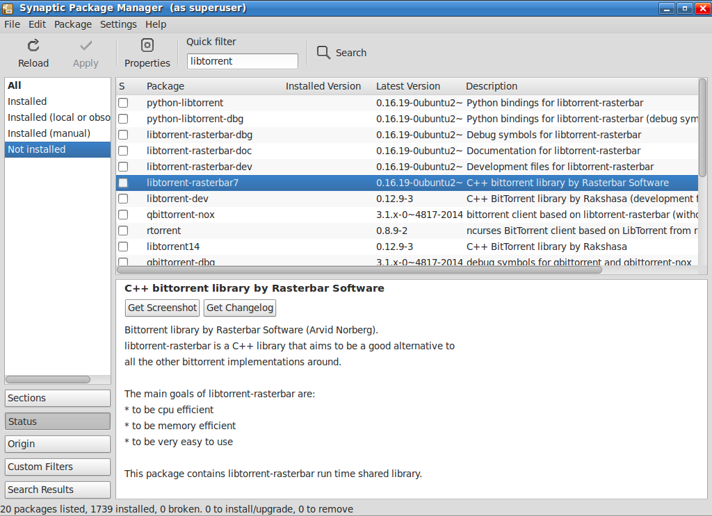

Would the "libtorrent rasterbar7 0.16.19 work from the repos?

Yes, but you'll have to make sure that the "qbittorrent" package depends on libtorrent-rasterbar7(=libtorrent 0.16.x) and not libtorrent-rasterbar6(= 0.15.x).
If it doesn't then it means it is compiled against 0.15.x and you'll need to recompile.
