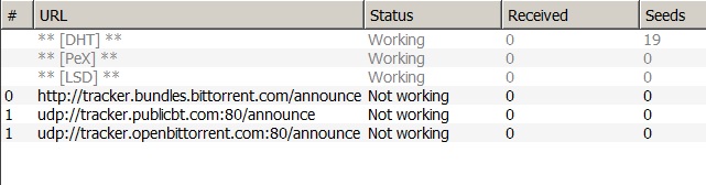

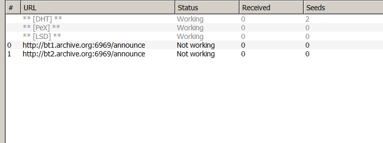

Issue: On 100% of torrents I download, every tracker's status is reported as "Not Working." DHT, PeX, and LSD are all "Working," however, and I am usually able to download/upload.
Below are two screen shots from two legal torrents. "Night of the Living Dead" from Archive.org and "Bribery Compilation_002" from now.bt.co. The trackers, like in all of my other torrents, are Not Working.
