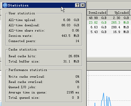

I've been trying out qBittorrent lately, but noticed an abnormally after short usage.
Basically, the All-time upload in "View-Statistics" shows 6.08 GiB.
Whereas the sum of uploaded data of all torrents is only around 3 GiB.
See the attached screenshot for detail.
(Notice that All-time download is about 3 GiB larger than per-task sum as well.)
I can confirm that I have only ever added the four tasks as shown in the screenshot. Nothing is filtered out of view.
The only thing I can think of is protocol overhead. But I cannot imagine it being this large.
What could be the culprit? Thanks!

Thank you very much for the detailed response. Now I have the big picture in mind. I'll continue using this particular copy of QBT to see if I can find some pattern. Would this delta be more related to more connected peers? uTP? Fast transfer rate? I'll test and see.

Also it's interesting to note that the "Session upload & download" stat seems close to actual torrent data transfer. So it seems that "All-time UL/DL" stat is using a different code path or logic counting the possible big overhead, whereas the session stats are not.

Since I've started this thread it's been another 18 hours of running, the margin has widened by a little bit, now it's at:
10.46 GiB "All-time upload" vs 7.03 GiB "Actual upload". Delta: 3.24 GiB -> 3.45 GiB (0.21 GiB)
Total session upload: 3.65 GiB
90.29 GiB "All-time download" vs 86.93 GiB "Actual download". Delta: 3.16 GiB -> 3.36 GiB (0.20 GiB)
Total session download: 1.96 GiB
So the "overhead" of download and upload is pretty close.
However, the big picture of download and upload is very different. Download is capped at 32 KiB/s with ~10 peers regularly connected, while upload is mostly idle with zero peers, connected to 1 or 2 peers from time to time and creating short bursts of traffic.
Upload tranferred more data, download connected to more peers, they ended up with roughly the same amount of "overhead" I am not able to come to a conclusion the prevailing factor.

Thanks for the follow-up. Recently I noticed that transport overhead can be separately displayed in the speed graph, and indeed it's quite significant. During a download session with 500KiB/s speed, overhead speed was ~20 KiB/s.
I also found that in uTorrent overhead speed graph can be further divided into "ack", "header", "connect/close", "retransmission", which seems interesting.
