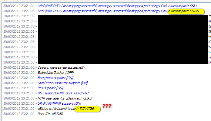

It's either not able to configure the port specified, therefore falling back to random port, or you already have something else using that port.
I know you said you're using upnp... but it may be one of the cases where it doesn't work through whichever configuration you have, try manually allowing the port in your firewall/router and check to see that it does now successfully use the specified port.
First to say that I have no problems with my ISP filtering my traffic. With uTorrent I'm seeding like a boss
Every time with green icon, that's why it was unusual for me to saw indication for connection problem.
Today I installed the new version 2.9.7 (uninstalled 2.9.5 first) and tested it with default settings. The result was the same - in every start qB gets random port disregarding settings. Applying screenshots -
At the 1st pic default settings - UPnP turned ON.
Second pic: UPnP turned OFF, the port 6881 opened manually in router
