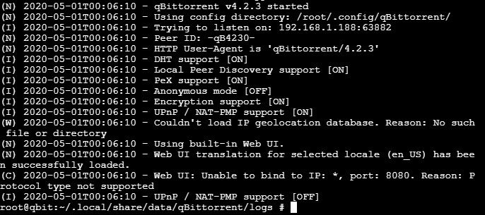

Hello,
Recently installed qBittorrent on my Freenas from the official plugins. Installation went quick and easy, I only had to configure an IP address for the jail and that's it.
However, qb doesn't want to work, the WebUI won't load because it's not listening. When I try to run qbittorrent-nox manually i get the following response:
Web UI: Unable to bind to IP: *, port: 8080. Reason: Protocol type not supported.
I'm kinda lost since I can't find this error message anywhere. I attached the log screenshot.
Please advice.

Maybe the jail system messes with ip/interface detection? Can't you set an interface/IP by hand?
