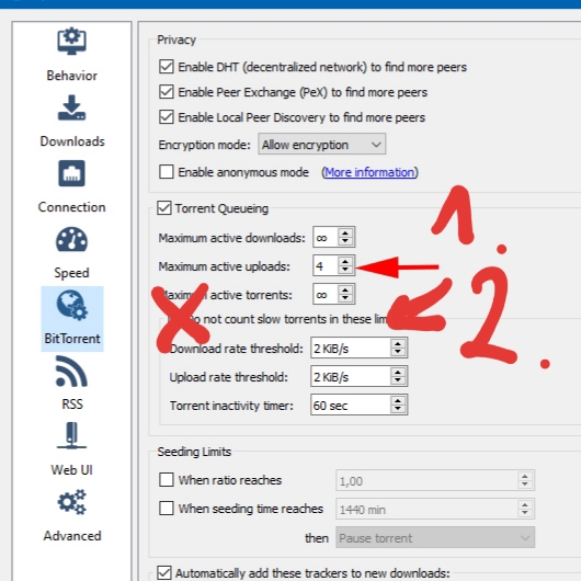

Go to settings and uncheck "Do not count slow torrents", then qBitorrent should respect your currently uploading torrent count limit, but then you'll be not able to find peers so often to seed other inactive completed torrents.
https://github.com/qbittorrent/qBittorrent/issues/14120

Sorry for bumping, but I thought I already found help to your problem. I previously shared a link to GitHub website, where I found similar issue shared by another user and shared instructions what you need to change in qBitorrent. In the GitHub link, there's even screenshots showing where the setting is. So you are not alone and there is an easy solution.
If you could write what is your native language, then I can try translating which setting is necessary to be changed in qBittorent.PriitUring wrote: ↑Wed Jan 20, 2021 2:16 pm Go to settings and uncheck "Do not count slow torrents", then qBitorrent should respect your currently uploading torrent count limit, but then you'll be not able to find peers so often to seed other inactive completed torrents.
