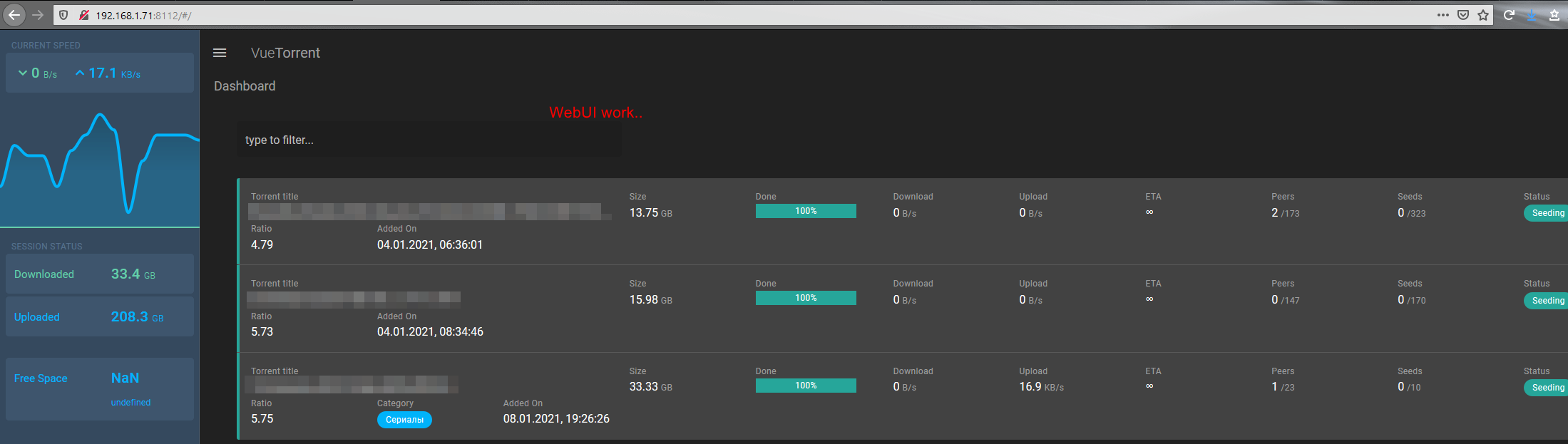

Hello! I use qBittorrent-NOX on OMV (Linux Debian). Version 4.1.5. It work, but regular WebUI interface does not suit me. Reason - checkbox "create subfolder" don't work - if I unchek it, subfolder is still created. I try Alternate WebUI, which are listed on the page: https://github.com/qbittorrent/qBittorr ... ate-WebUIs

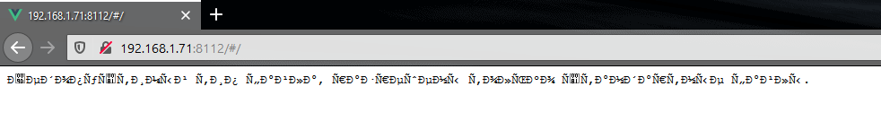

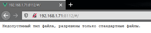

I try "VueTorrent" and "qbittorrent-webui-react". Checkbox work correctly in "VueTorrent" - subfolder is not created. But I have problem. After I set alternate WebUI in settings of programm, page automaticaly refreshing and I have result and work. Good. But, if I open page in other browser, device, or I close and open same browser, or I open page of qBittorrent WebUI in private mode, I have white blank screen with one line: "Недопустимый тип файла, разрешены только стандартные файлы.". It incorrect coding page, Western Europe. I change it to correct - Unicode, and I have text "Недопустимый тип файла, разрешены только стандартные файлы.". It's russian (I'm russian), translate "Invalid file type, only standard files are allowed.". Such a problem is observed on both trying alternate interfaces. Standard WebUI work always.
Thus, alternate WebUI only works 1 time before I close a browser, then I have to reset the settings in the configuration file. And install the interface again.

WebUI work correctly after I set it on settings
After close and open browser
change coding page
change coding page

Try to copy index.html to login.html, so you will have 2 identical files
Original error message: Unacceptable file type, only regular file is allowed
