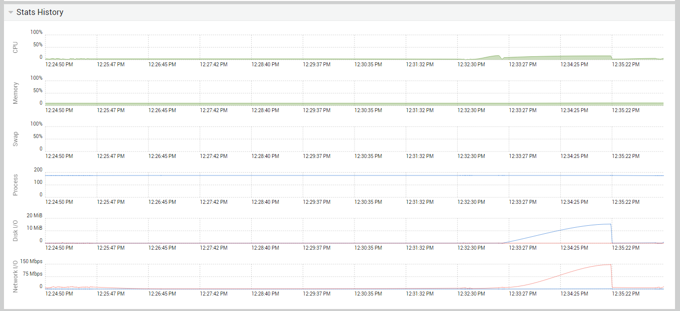

Hi, after upgrading from 4.1.3 to 4.3.3 (I think ubuntu server was bumped also), my home server is having random but regular freezes. The freeze lasts for 5-30seconds, and randomly repeats (usually 5-10 minutes). During that time, connection to the server is down, ping fails, samba share breaks, webui for qbit is down. If I'm logged on directly (keyboard & monitor) to the server, the CLI is responsive, but network seems to be down (pinging my dhcp router fails). Also, during freeze, webmin stats show this (notice the bump at 12:33):

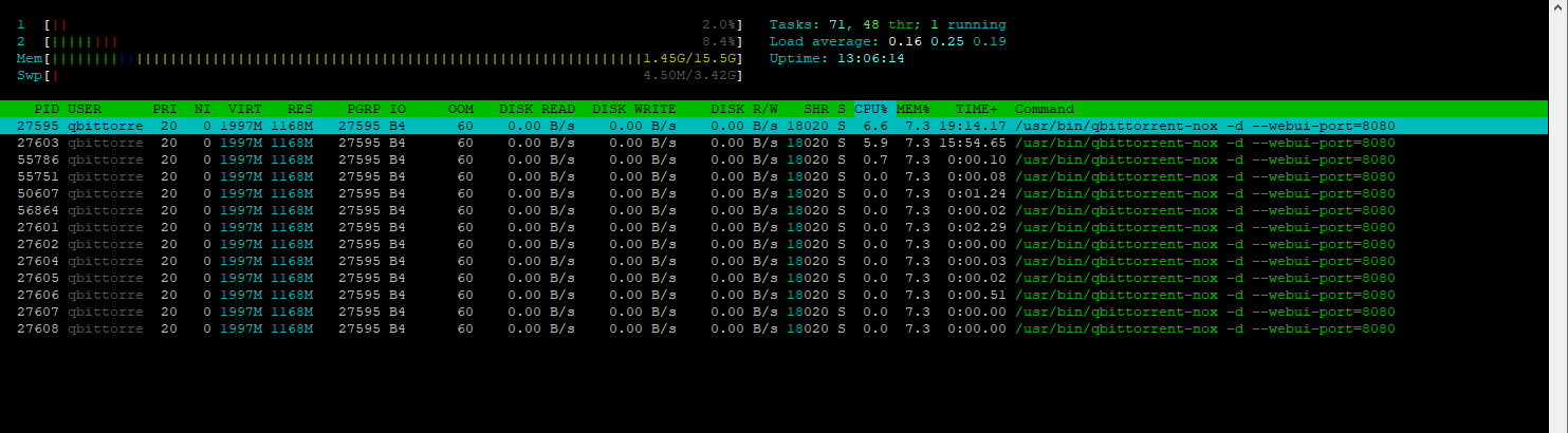

The memory usage during these freezes doesn't seem to be affected, swap is constantly low, real memory usage is showing 14%. I ran htop, IO rates seem normal, cpu usage also, only memory seems a bit high? 2GB? Is this ok, not sure what are "normal" numbers?
I just tried downloading to nvme ssd and the freeze again happened.
