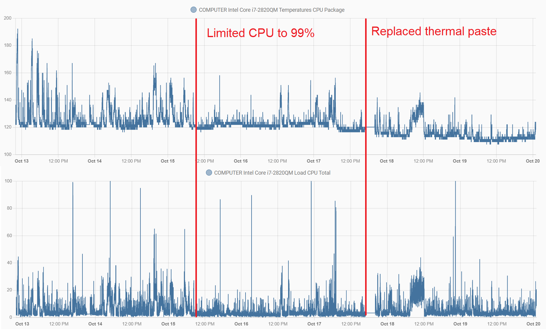

I probably should have given a little more details about my setup. I'm using the laptop only as a media server (Plex/Sonarr/Radar/qbittorrent/Jacket/VPN) and for HomeAssistant running in Virtualbox. As long as I can keep that all running coolly the laptop is doing everything I need. It sits on a table, and I mostly never touch it.

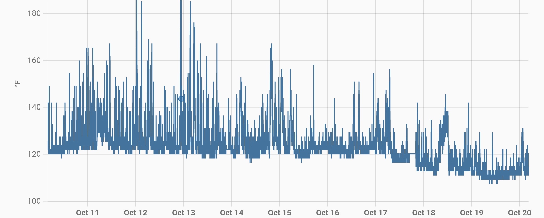

Just a last follow-up. I replaced the thermal paste, it was a pain in the ass because I had to remove over 20 screws to get at it, including the keyboard. The old thermal paste was hard, and difficult to remove. Doubt it was doing much anymore. Put on some Arctic MX-5, reassembled.
It was surprisingly effective. The idle temp deceased by 7-8°F. And the CPU under load hasn't gone much over 140°F since then. I took a screenshot of the CPU temp and CPU usage logs.
EDIT: just realized I mislabeled when I limited CPU to 99% max, that was actually late October 13th.

Limiting the CPU to 99% was pretty effective in reducing the number of higher temperature spikes.
Re: How to reduce laptop heat while using qbittorrent?
Damn that's some nice detailed data there! Appreciate it!
