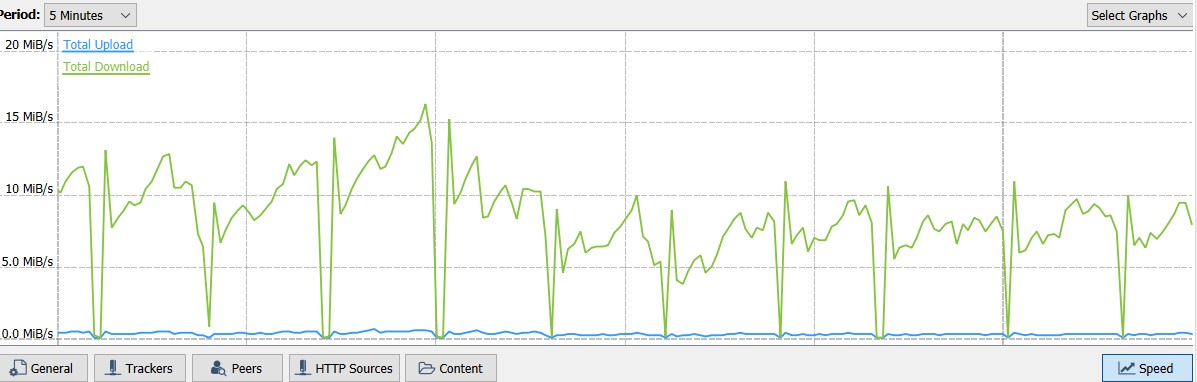

When downloading over a wired 1Gb LAN, using WIndows 10, the torrent speed will drop to 0 at very regular intervals. See the attached speed graph.
Is this something I can correct on my end?
Or is this a behavior of the torrent system out of my control?

Re: Speed drops to 0 at Regular Intervals
In 4.4.0 it seems its downloading for x amount time, and then flushing a cache (swap flushing as you are calling it) or something, while this is a different behavior than on 4.3.9 or previous.
Seeing the same as the user above, but a much bigger extent, as downloading with 1gbit.
While its flushing the cache it stops downloading. This is not happening on 4.3.9, I re-installed 4.3.9 and its back to normal, so something changed.

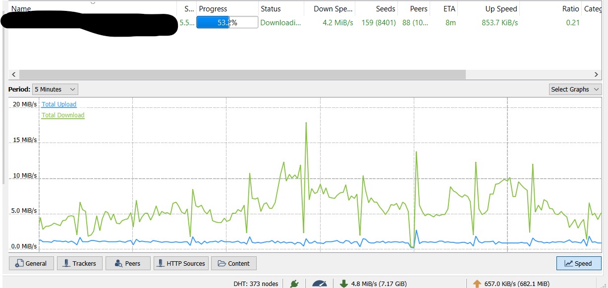

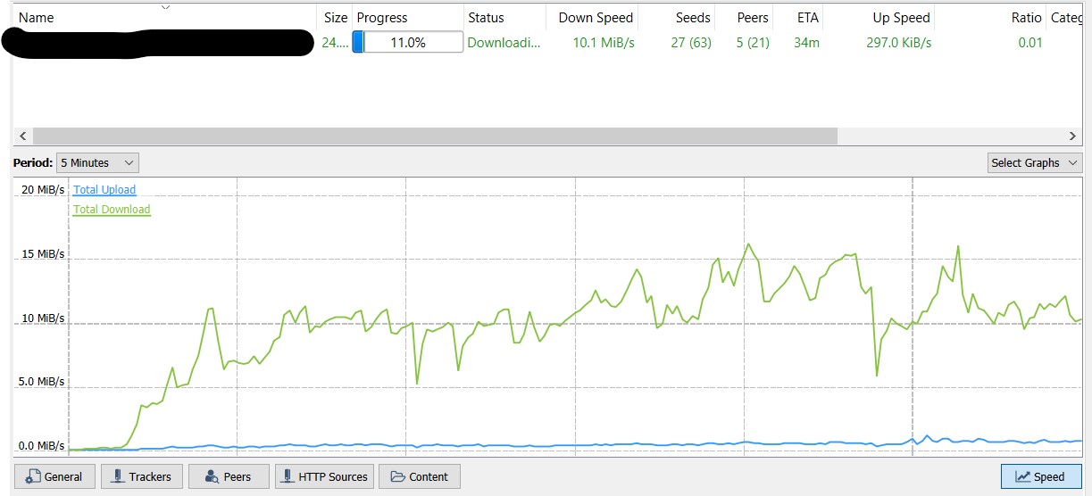

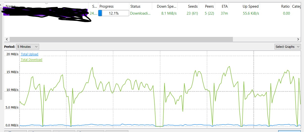

This is Qbittorrent version 4.4, Windows 10, saving the file to a Synology NAS over a 1Gb LAN.
I used to see a nice contiguous data flow, I think before the upgrade, now I get these regularly space data drops. The download completes but I have not seen these drops before.
Regarding Seeders, the first chart attached shows 23/61 and for comparison, the 2nd chart shows 150/8400.
Both seem to exhibit the regularly spaced data dropout.
Looking at the destination NAS performance, I dont see anything that comes close to a limit such as Disk and Network Utilization. Probably in the <10% range.
I have no limits checked in Qbittorrent, up or down, it's fully open both ways and most settings are at default.
In the best conditions, I can get up to about 16 MB/s downloads with my Internet Service Provider. The VPN is PIA.
The first chart is the same torrent as the first post again this morning. The 2nd chart is a new torrent with 8400 Seeds.
Yes its version 4.4 that is the issue.
I installed version 4.3.9 and now the download is contiguous without the regular drop outs.
Here is a download graph of the exact torrent that was first posted but now using version 4.3.9.
Note it has no regular dropouts.
I hope this is helpful.
