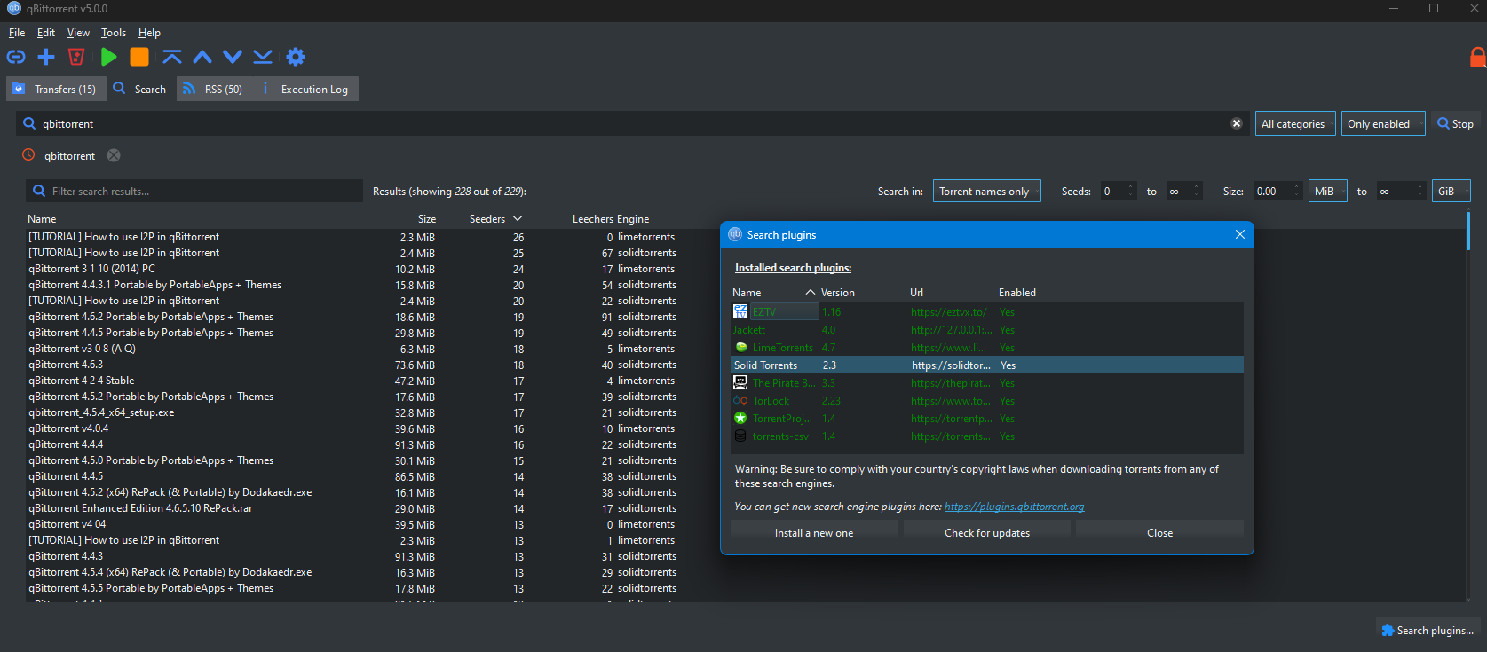

Nah. I clicked "search for updates" and it worked fine.
All updated, searching, working.
Custom themes also working if someone is bothered by the colors. (thank Qt for that lol)
Other issues: Found none other than the color change.
Speeds are maxed on 2GBps+ on 5+ machines using 3 OS.
Worksforme™️.

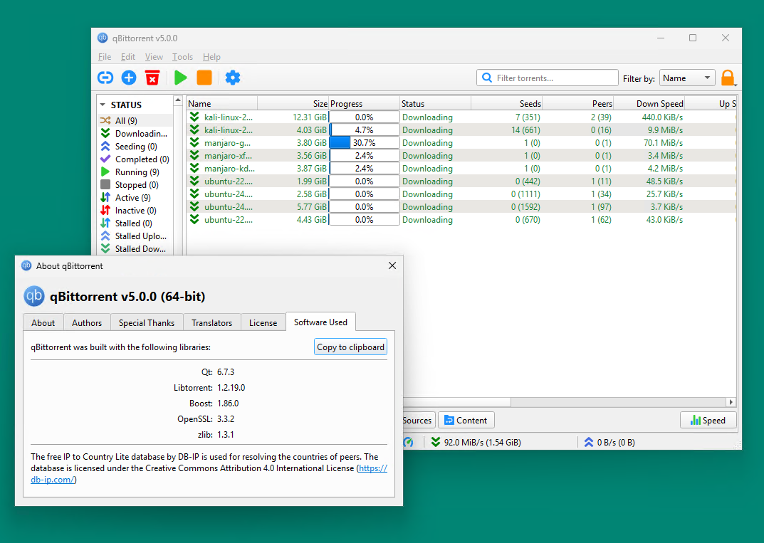

Re: For those who are experiencing issues with 5.0
Just in case someone says "but it only works" no. No it does not. It works. PEBKAC.
Screenshot 2024-10-04 114053.png (181.87 KiB) Viewed 12976 times
Screenshot 2024-10-04 113632.png (118.58 KiB) Viewed 12976 times
Really.
Just like how you would install them since like v2, on bottom right click search plugins, then search for updates. But, if this is too challenging, you might want to reconsider that warning on first start. You may run into trouble with random public downloads.
MikeTaku wrote: Thu Oct 10, 2024 11:26 am How can you easily search for and install plugin updates, and why should you be cautious of downloading random public files?
How: I just wrote it down... :(
Why: 1) Because of p2p laws per country. If someone is unfamiliar with basic software controls, they might not know the laws in their country. 2) Because anyone can upload anything and these unknown uploads can contain malicious files.

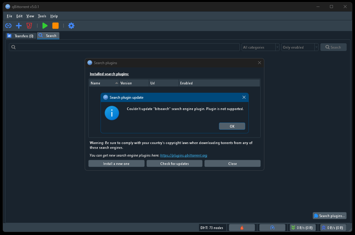

unable to add any search plugins get the error not supported, I clicked Search Plugins, check for updates and nothing is now supported nothing loads..

johnnydorayme wrote: Tue Oct 15, 2024 10:10 pm unable to add any search plugins get the error not supported, I clicked Search Plugins, check for updates and nothing is now supported nothing loads..
Welcome to the Club...
Let's go back to v4.6.7 until they hopefully fix it :P

BTW, v5.0.1 is as Problematic as v5.0.0 has been when it comes to Search Plug-ins.
Different version, Same Problems... :P
P.S.
Windows:11 23H2 x64 & Python:13.3.0 x64
And when I tried to Manually Install a Plug-in, it was impossible...

SEARCH, I managed to fix my problem remove all versions of python other than the latest 3.13
