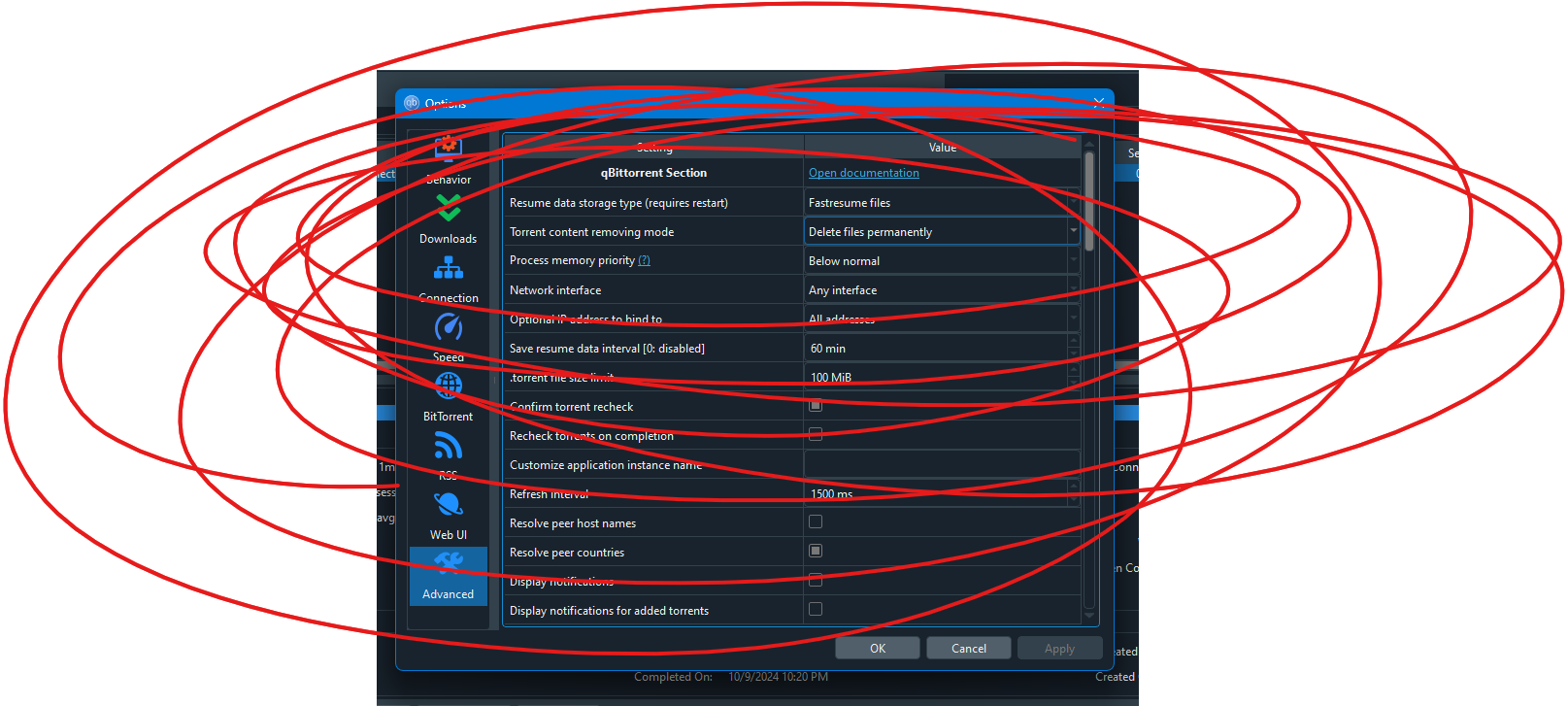

I dont see that option neither in QBT or WebUI. QBT 5.0 "disaster"
Re: Torrent deleting issue
corsario28 wrote: Thu Oct 17, 2024 10:26 pm I dont see that option neither in QBT or WebUI. QBT 5.0 "disaster"
tried to highlight it a bit
