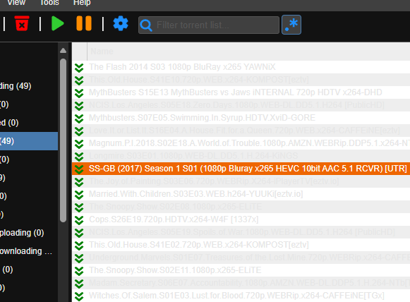

I just upgraded to version 5. While at first I liked all the colors, it quickly became obvious to me that all that blue is unreadable! Any way how I can get it to a normal look again?

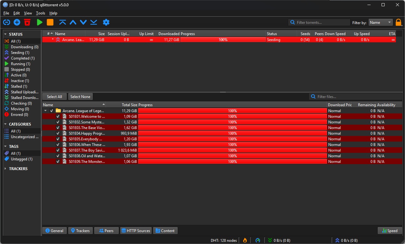

The dark theme os OK for the actual desktop interface, but unusable for the webui.
Screenshot 2024-09-30 223232.png (67.53 KiB) Viewed 9664 times
Re: qbittorrent 5: how can I disable all the colours and the dark mode?
SonjaDC wrote: Tue Oct 01, 2024 3:36 am The dark theme os OK for the actual desktop interface, but unusable for the webui.
- You can use custom dark themes for desktop.
- You can use VueTorrent for webUI: https://github.com/VueTorrent/VueTorrent
