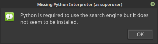

Hi, using latest version of QBittorrent 4.0.3 on Linux Mint 18.3 Sylvia. I tried searching using the inbuilt engine, which I have never had a problem with before, and it is giving me an error about missing Python. A python -V command returns "Python 2.7.12".
Help would be appreciated. A bug, I do not know.
Screenshot at 2018-02-05 12-40-31.png (14.58 KiB) Viewed 867 times

I have uninstalled the version downloaded from this site and have installed the version in Mint "Software Manager" and that appears to be exactly the same, version 4.0.3, and displays the same problem with missing Python.
Screenshot at 2018-02-05 16-42-16.png (9.28 KiB) Viewed 865 times

Solved it. Firejail was somehow causing Python to be hidden. I had to purge it then the client functioned as it should and search works.
